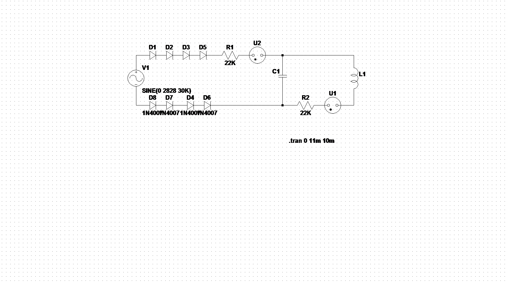

        • I'm wondering if anyone has been able to replicate this simple circuit described in this video: https://www.youtube.com/watch?v=Q3vr...ature=youtu.be
          It was mentioned in this thread some time ago: http://www.energeticforum.com/177622-post2461.html
          I believe the circuit is as described in the attached file and works on the principle of standing waves.
          Unfortunately I have been unsuccessful in my efforts with the circuit.
          • p75213 I had the same issues trying to make the base circuit. That looks like a standard parallel tank circuit L1 coil exciter. You should be able able to do it. Series or Parallel it does the same thing; ocillation. You are rectifying your AC from the NST, it fills the cap, when the cap is full, it dumps across the switch(Spark Gap) and energy creates a magnetic field on the coil. Cap is empty but as soon as it discharged it the coil collapses and returns energy back to the cap. The two components; cap and coil are energy storage devices. They teeter-totter the energy back in form in an oscillation. They create a standing wave at the resonant frequency.
            The math is Here
            The tough thing are the spark gaps, because too large and the potential can't jump. Also spark gap placement depending on the tank type. I worked with small engine spark gaps or gas discharge tubes (GDTs). That's why you see tesla coil with adjustable gaps. Your video uses those bulbs, and I bet they don't last long. GDTs have rated voltages.
            Your problem is not the recipe, it's the ingredients. If you are interested on simulation, look up circuit simulations for a Tesla coil. (Hint) There are easier ways of getting a standing wave L1 coil, and resonant L2. But understand having a resonant L1 and L2 alone, doesn't buy this massive energy source. At least from my experiments.

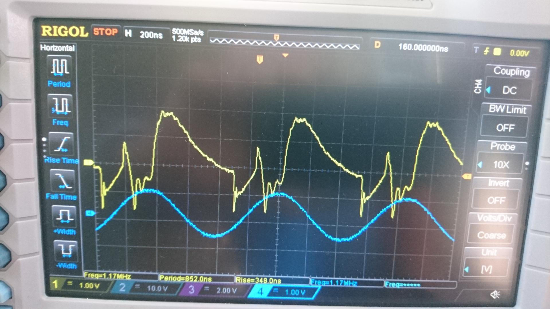

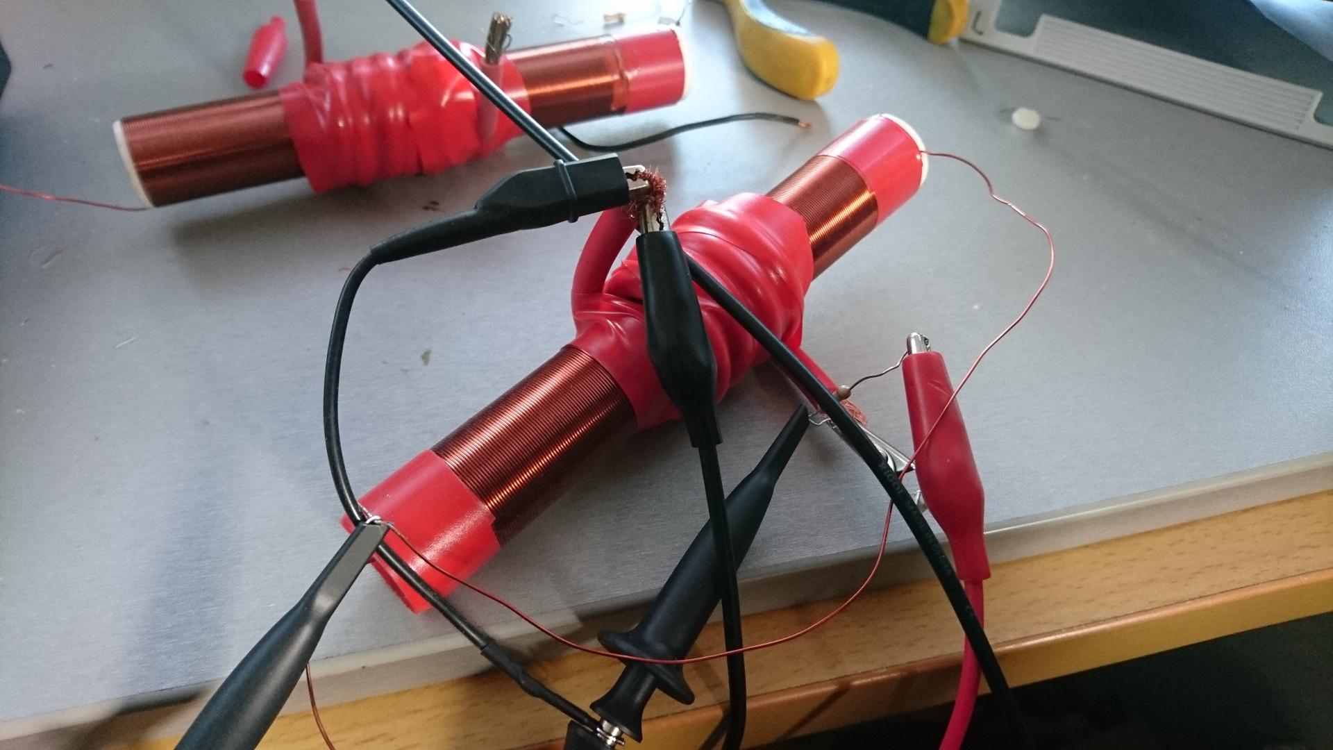

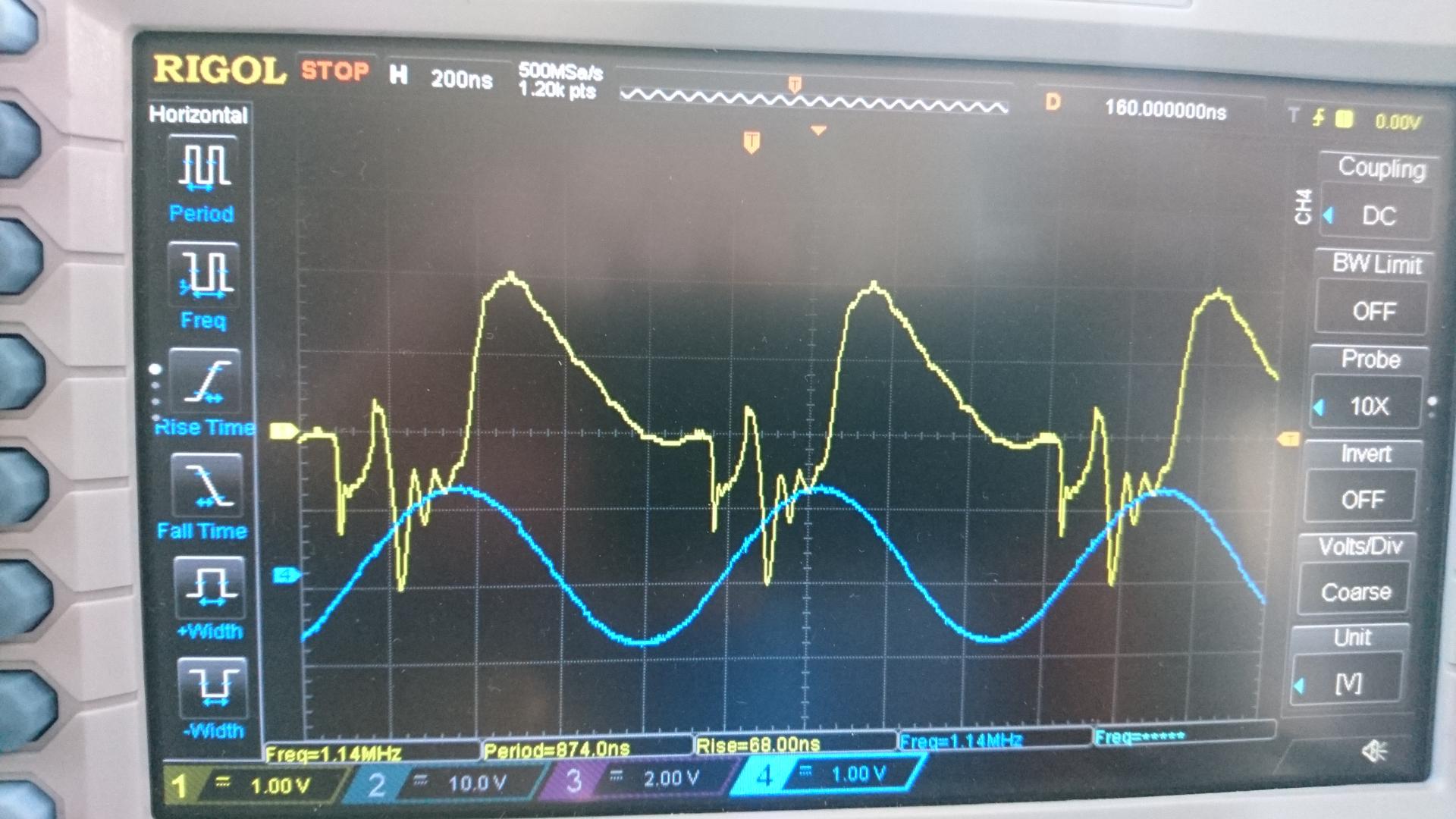

                    • Slayer
                      Hi ilandtan,

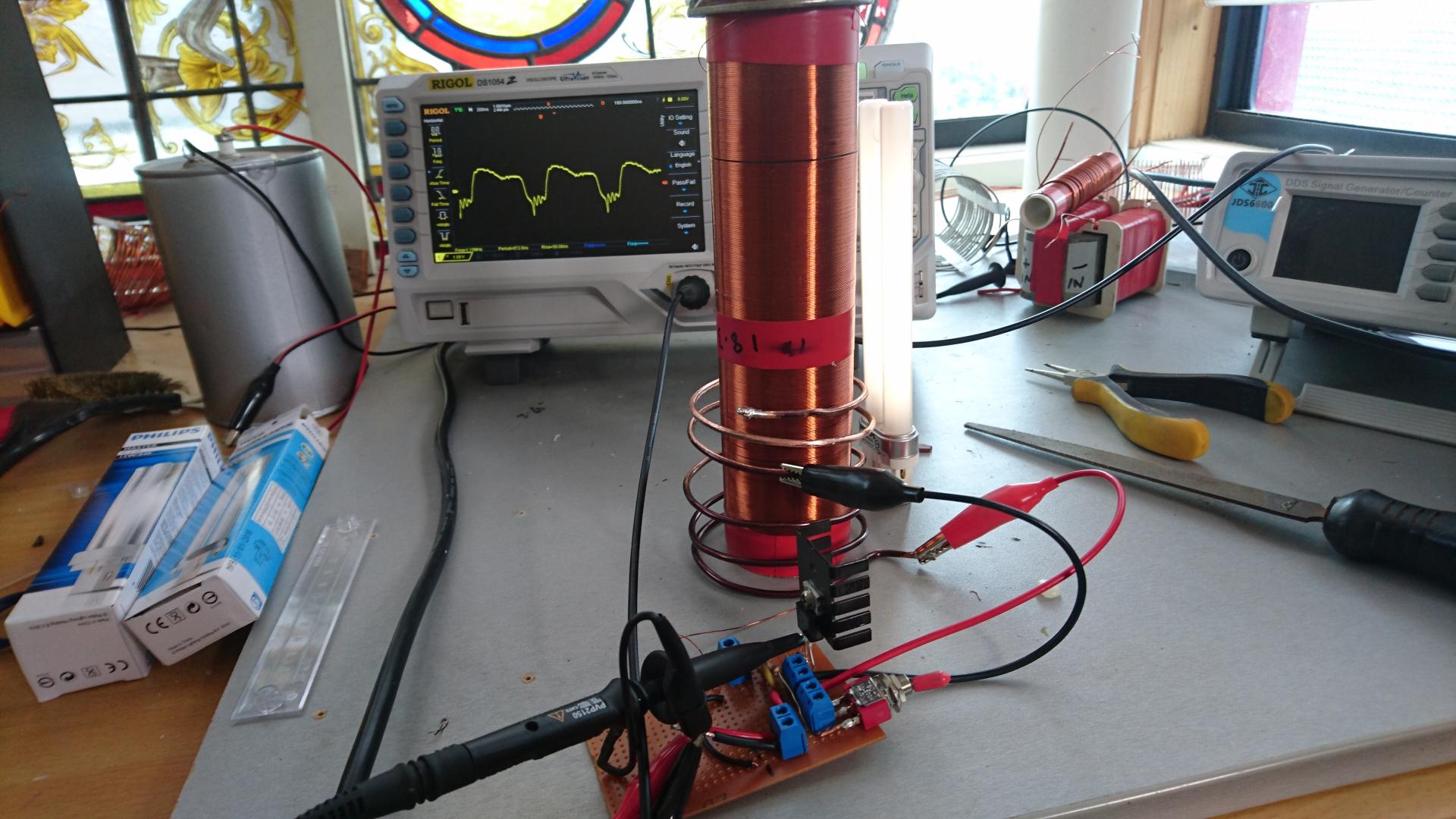

                      Raining today so no building site! I have built a "slayer", and some of the results confound me somewhat. I am not sure how to measure resonance, unless it is by current flow. I'll try that later. Sun is out so back to work!
                      Here are some photos. They are taken with the changing variable being moving the connection down the L1 coil. Not much change, but change there is. As the L1 gets smaller so too does the output frequency! I would not have expected that. Also, the L2 output gradually increases in output. However, I am using a magnetic coupling so the measurement is somewhat proportional to the distance of the pick anf the L2 coil.

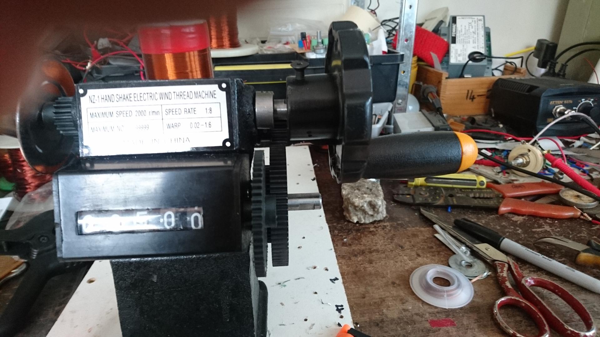

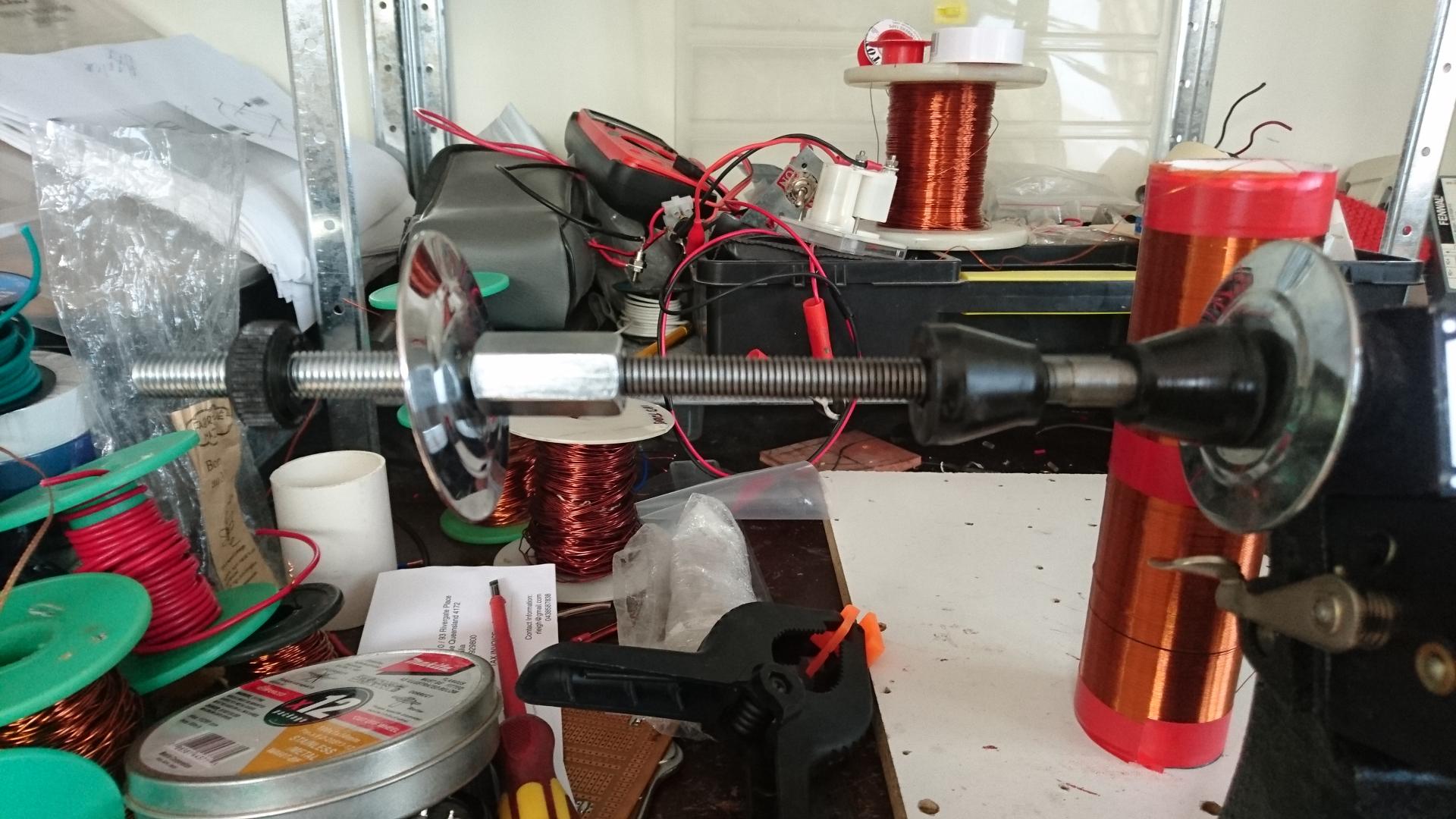

                      I have had to modify my little coil winder to accommodate the longer coil wind. I can now wind literally up to 2 meters! - with a support at the end of the shaft!! I post these pics for those who are hand windingto see how cheap it can be to get a small winding machine and modify it in a simle manner. I have also out a handle on the direct shaft to get a 1:1 wind ratio. Machine is 8:1! Too fast.
                      • Coil winder
                        Here is the coil winder I got on ebay - "Cheap" for what is does! To accommodate longer coils and slower winding I have made up some shaft extenders using allthread rod and pipe. I have removed the original handle 8:1 ratio - too hard to wind, and put a handle on the direct ratio 1:1 shaft. I wound the coil in the previous post in 2 minutes!! Using very long lengths will require a support bearing at the end of the shaft.
                        Current listing
                        Enjoy

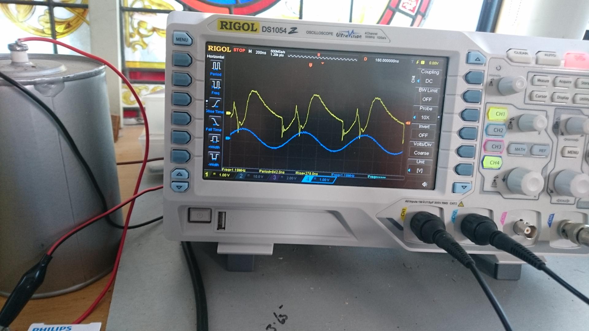

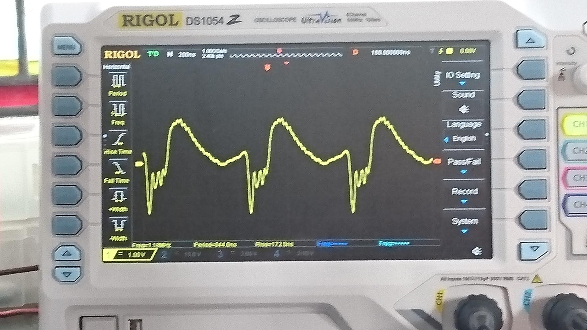

                            Hi ilandtan,
                            Thanks for the advice. I get what you are telling me. However, I do not seem to be able to see the wood for the trees! I am using the scope to look for incremental increases as I adjust the position of the input to L1.
                            The image I get on the base of the transistor, I am not able to quantify such that I understand the strength of efficiency of the feedback from L2. Also, I am not sure what I will see if there is resonance!
                            Winding direction is a good tip. By pure luck I have two L1 coils with different weights which are CW and CCW. If my L2 is CW, I should be using CCW L1 to my mind and with the negative connection at the bottom of the coil. Small issues, but important. Haven't tried the arc length, will look at that tomorrow. Off to bed.
                            Also, I am only running at 6v and my current changes greatly about the centre point of one of my L1 coils. I have a tip31c that I am using and it gets quite hot. Double the voltage quadruple the power! Blow the Tip off!

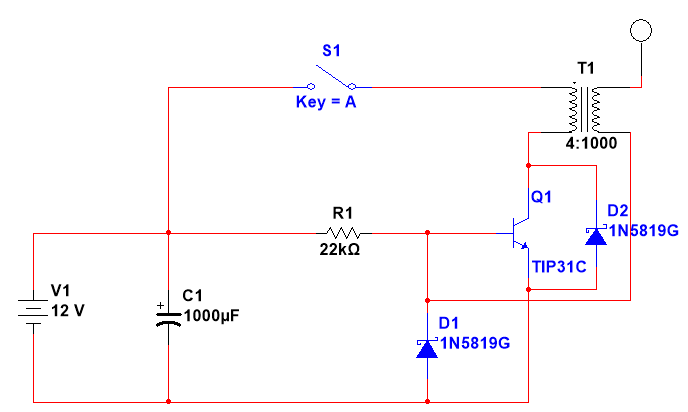

                                Hi ilandtan,
                                here is the circuit I have been using. I don't have the schotsky diodes so I have used 1n4148. When I say hot, it is medium hot, does not burn the fingers at 6v. current draw at what i think it the optimum is 550ma. I get a lot of dual images on the scope.
