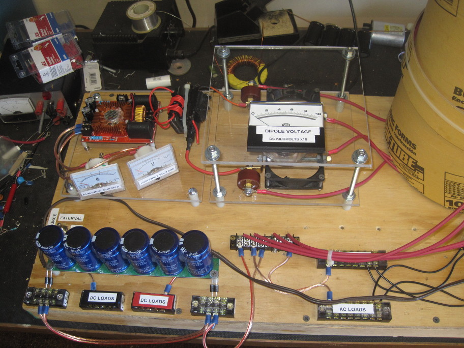

                              • OK, latest build progress. How to mount the meters: go vertical! This took me more hours than I intended to fabricate, but it works. Still have to mount the meters on the HVM board. Also, having the metal rod this close to the HV section is not good. I need to get some nylon fasteners and threaded rod instead, it exists but not at the local hardware store....
