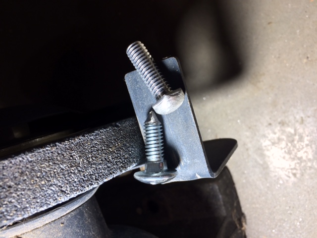

    Steel and aluminum bolts for the PPV .
    I just wanted to say thank you to tswift, Mwtj and Serendipitor for keeping the PPV details a secret.
    I know this next move will be appreciated as they won't have to conceal any part of the device from anyone.
    I won't have to photoshop any pictures either.
    I present to you the Perreault Plasma Valve Stage 1
    These pictures are courtesy of tswift & Serendipitor:
    The anode should be made from aluminum.
    The cathode should be made from iron. (Steel is close enough)
    However, there is a little twist in the story
    The most efficient PPV Stage 1 can be made by having a domed anode and a pin point cathode!
    So opposite of what is shown in the pictures.
    If you have access to a lathe then I'm sure you can make a better dome.
    The finer the threads the more adjustable your PPV will be.

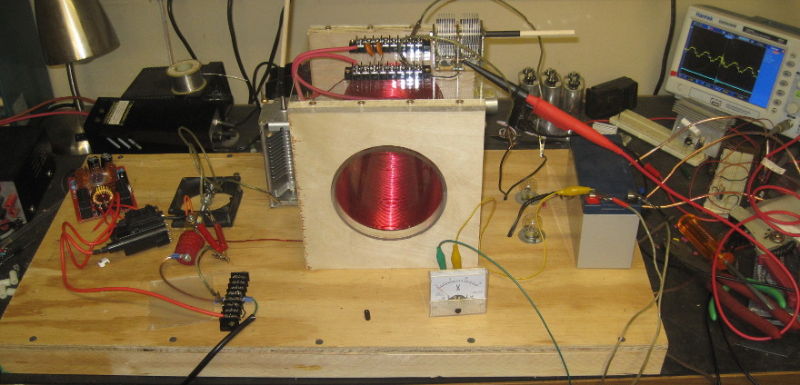

                            • Lots of sparky-sparky, resonance still elusive
                              I had some time to spend testing the device this evening. First I rewound the L2 coil with HV wire, as it was apparent that with the whole L1 coil charged to 12KVDC potential, the wire I was using was not going to insulate against that kind of difference. It looks like I will probably have to make another L1 coil and do it right with HV wire but as a half measure I just did L2.
                              I also used my new HV probe to measure the floating potential on the L2 side circuit and I found that it was at about -3.5KVDC, with a blip every time the PPV fires. This can be seen in the blue scope trace in the picture. Unfortunately, my antenna is not at the same place as my shop building where my electronics workbench is. To test the rig I have to haul the whole thing outdoors and about 100 yards away. To make my life simpler for testing and tuning, I use an antenna simulator so I can power it up in the shop. I don't believe this will give the same effects as the antenna will, but it will make the PPV fire and coils ring and can be used to check resonant frequencies and proper operation of the circuit. Now that I stocked up on some HV resistors, I use a 100M resistor to ground from the connection where the antenna would go. This gives a firing rate of about 500 Hz on the PPV. There is enough current leakage due to either conductivity in the wood, insulation leakage, or corona that I get just a little sparking in the PPV even with no antenna and no resistor.
                              Since the circuit seemed to be operating properly I hauled it out to the testing location. With the antenna and ground connected I got a strong spark, I didn't bring the scope out but it was audible and sounded similar to when it was on the bench, so several hundred hertz. I tuned C2 up and down slowly and carefully looking for any change but didn't notice anything. I left C2 at the position I tested to be 500 KHz on the bench and tried tuning C3 instead, but likewise nothing. So I brought the test rig back to the shop for further tuning. Somehow it's still far enough out of tune not to be even close, more troubleshooting is needed. Also, I may not get any results at all with the magnet wire coil, it seems that the HV wire really is a must.
                              I'm encouraged that this is a step forward, at least I'm getting good charging voltage now. The static charging effect around the device is noticeable and I get a zap every time disconnecting the battery. The ozone is also significant, in the shop I have to run a fan to help dissipate it.
                              • I figured out at least part of the problem. Originally I had designed the L2 secondary as a smaller tube within the L1 primary. I arranged the C3 capacitance for resonance with the measured inductance of the L2 coil done that way, and I never changed it when I swapped L2 for two turns of wire wound around the outside! Silly mistake, it will need much more capacitance to resonance at 500 KHz.
