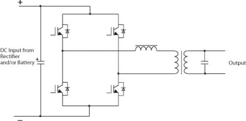

                • Originally posted by drak View Post
                  Well, it seems I don't have a center tapped 12-0-12 transformer. So cognito's h-bridge idea sounds like a good idea. Anyone have any suggestions on parts or a circuit for h-bridge able to handle 120vdc input?
                  Hi,
                  Using bipolar switching for SPWM single phase h-bridge makes pure sine wave and we can control voltage and frequency very accurate (SPWM micro controller, ASIC). Most inverters make pulsed sine wave shape and causes disturbances in electrical sensitive appliances, if you use simple devices it works fine but using audio or TV use pure sine wave type. Mostly better sine wave than from the electrical grid.
                  If you want to have 1000Watts H-Bridge use 8 MOSFETS to handle more current (4x2 in parallel). Or use higher rated ones (more expensive). Use 400V DC supply for input to the MOSFETS or IGBTs.
                  If you can use all sorts of transformers. (rated for max. RMS total output watts required). Center tapped transformers also work with 12V DC supply.
                  Best regards

                    • Originally posted by cognito View Post
                      Hi,
                      Best regards
                      Do you have exact schematic how to drive those mosfets ? Can I use any mosfets ? How pure is sinewave, what is the distortion ? I need something like this for other project with only 200-500 W max output.
