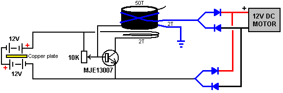

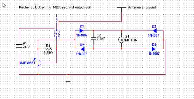

So DC is flowing via your insulated (?) antenna !
I wonder if you can meter this using a DMM but with 100uF across your probes to smooth the spikes and show average DC: Hence establish beyond doubt that your circuit is drawing energy through the bridge ?
Using two LEDs like that protects against reverse potential destroying the junction of a single LED if unfortunately it were initially connected the wrong way round.
