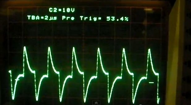

Hi Laurent,Originally posted by woopy View PostHi all
going on my experiment
hope this helps
good luck at all
Laurent
charging by induction approach 2.wmv - YouTube
Interesting combination of circuits.
I would like to focus on these circuits with other forum members. To that end, I created the thread http://www.energeticforum.com/renewa...collector.html
Relevant, on-topic contributions (postings) are welcomed there.
Best Regards,
Berg

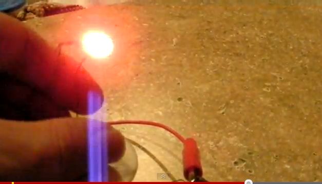

This is a very misleading video, and the presenter is not well versed in what he is doing. Primarily his amp meter is designed to show DC current, but he is driving with ac, this will always show zero.Originally posted by zilano View Postbifilar resonance with output and no draw in amps
Resonance in a Bifilar Coil - YouTube
courtesy utube uploaders
I have played with MANY MANY bifilar arrangements in various modes, documenting impedance points at various multiples of their fundamental, noting in particular when impedance maxes or zeroes (or close to). They often have several points of high impedance acting like a parallel tank arrangement however since they are not lumped element, there are several such points. The amp draw will be low, because impedance will be very high, and you will still be able to light a bulb led or similar. There is no magic here. One of the values of such an arrangement is the increased capacity due to the fibular arrangement will bring the resonance to a lower frequency, however at the cost of Q (P-P voltage will be lower at high impedance mode).

thankx for ur comments but surely this is the key if u want to understand it.Originally posted by Armagdn03 View PostThis is a very misleading video, and the presenter is not well versed in what he is doing. Primarily his amp meter is designed to show DC current, but he is driving with ac, this will always show zero.
I keep an eye on this thread, and love many of the great things shown. I particularly like many of the katcher style oscillators. i have come up with a design based off of this which can drive higher harmonics of the solenoid, by filtering out the lower ones at the base.
u r right about dc ammeter. its wrongly used here. this video is for understanding don 3rd coil harvesting.

Why would an analog milliamp meter show any draw in current at 300 Khz from a function generator? The output from an FG may be in microamps and I don't think an analog meter can detect any output nearly as high as 300 Khz. Am I wrong?Originally posted by zilano View Postbifilar resonance with output and no draw in amps

Ah - I see others already caught that about the meter but I think I understand what is being shown. I wonder if you could not get the LED to light regardless of which 2 wires you hook up on the coil to the FG.There is no important work, there are only a series of moments to demonstrate your mastery and impeccability. Quote from Almine
