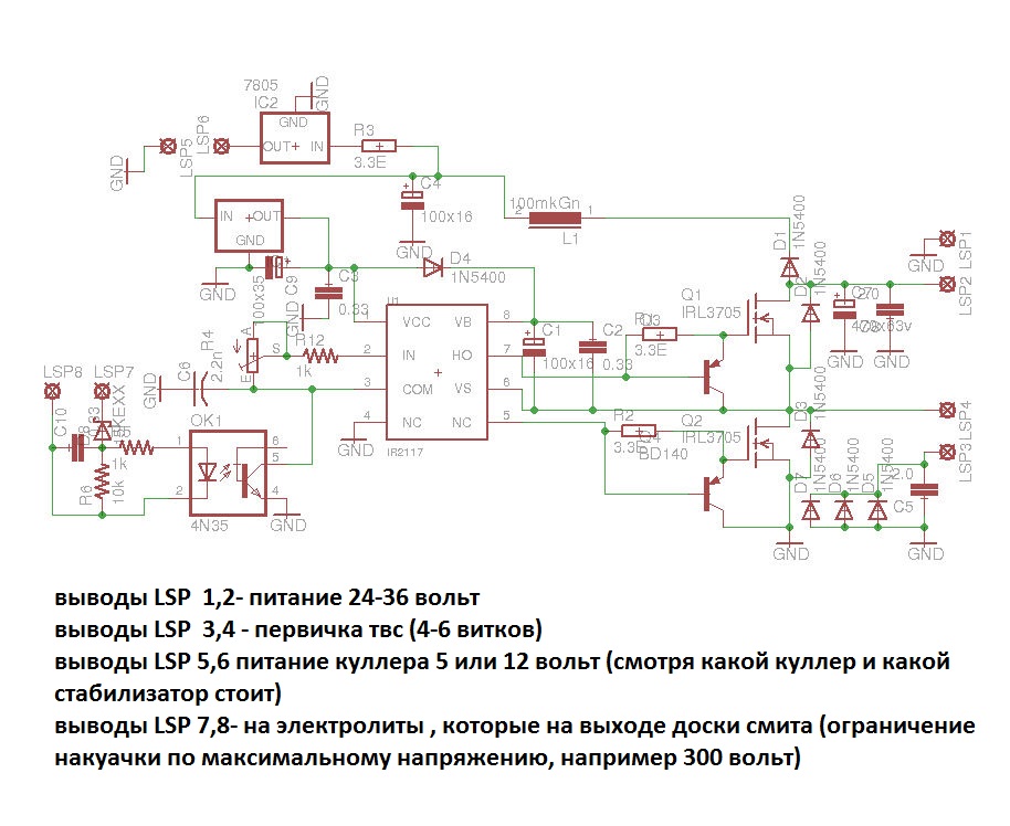

I'm using this for now, Dynatron using his own driver with 50hz modulator (based on 555 timer). he said will post modulation scheme for attached driver.Originally posted by soundiceuk View Post
Garsony please can you confirm this is Dynatron's and Destine2012's flyback driver and where they got the parts for their flyback from.
Also very importantly what materials is there spark gap using.
Many thanks team
