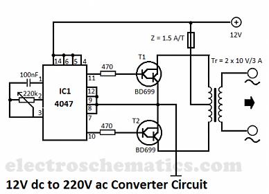

I know they should be here parallel to primary coils and they should be turned on/off sequentially because that is how this circuit works I think (push-pull ?).
