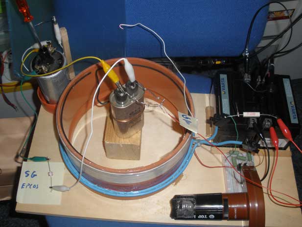

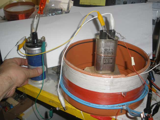

                      For today i redo a bigger Kacher , i called the Swiss Kacher because i wound 25 turns of red 0.8 mm plain copper wire plasitc insulated and another 25 turns in white . The form plastic PVC is 21 cm outer diameter.
                      This kacher is really easy and quick to wind .
                      The primary is 2 turns pancake 2.5 mm stranded copper wire plastic insulated.
                      I used the same transistor circuit as per my previous flat kacher, and it works beautifully.
                      The amp draw is 225 ma at 24 volts. The frequency is arround 1.7 mHz. So i can perhaps tune down with a cap to 1.095 mHz
                      The black wire inside is the loop antenna in 1.5 mm copper wire plastic insulated .
                      Have also got 2 x 12 volts lead acid battery to avoid the power supply.
                      Just for info in the system as per this video amazing sparking between car coil and kacher 1.wmv - YouTube, i could replace the ground by an air antenna (at the end of the AV plug) to get the sparks. I get already small amount of sparks with a 1 meter air antenna.
                      OK a lot of experimenting youpp!!
                      hope this helps
                      Laurent

                        • Hi all
                          just for fun , i decided to make some order in my system.
                          So i fixed everything steadily on a wood plate
                          So i could also shorten , minimise and / or suppress some of those crocodile connections.
                          So at the end, i have my frequency from 1.7 mHz down to 1.28 mHz.
                          So it seems that, in this operation, the length of the wire connections are of atmost importance.
                          Hope this helps
                          good luck at all
                          Laurent
