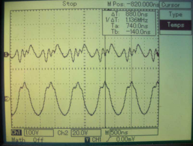

Hi Conrad
great work bravo
There is a lot to learn with this setup
Perhaps you can answer this question, or perhaps Dragon(Znel) can ?
In the Kacher exciter , the primary coil (2 turns ) is normally DC pulsed, so the current in the coil is always pulsed in one direction, from battery positive , accross the primary coil, than accross the transistor (on and off switch) than to battery negative.
So why do i get a kind of AC sine wave in the primary coil ? which produces an almost perfect AC wave in the secondary coil and also in the coupling wire loop?
What is the origin of this AC wave in the primary coil ??
And why is there no flyback spike in the primary ?
Is it possible that the flybackspike is so large that it produces the kind of sine wave, i notice on the scope shot here under ?? (channel 2.(the probe is attached at the output of the primary and not grounded)
Notice also the trace of the input current (accross 1 ohm resistor ) at channel 1. The wave is up and down the middle point as if there is a negative current coming back to source ?
And for finishing, the amplitude of the current wave (channel 1 ) decreases when i approach the wire coupling loop and the bulb begin to light ?
Very interesting isn't it
Good luck at all
Laurent

Quick answer
Laurent,Originally posted by woopy View PostHi Conrad
great work bravo
Good luck at all
Laurent
I have to go now, therefore just a quick answer, more tomorrow:
The curves you observe (over the shunt and for the primary) are very similar to curves I observed during Joule Thief and Exciter experiments with air coils.
Yes, the back emf goes partly back into the power supply (therefore the negative part in the curve over the shunt).
According to my knowledge, the sine wave in the primary is caused by the back emf. This is the whole point in a transistor oscillator with an inductor (coil), a way to turn DC into AC oscillations.
Greetings, Conrad

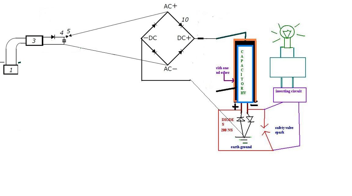

Some Notions:Originally posted by Jokyb View PostIts nice to see you back Zilano! I have learned a lot from your posts many of the forum members with extraordinary talents.
Can you tell me if the circuit below has any chance of success before I start purchasing parts.
rgrds,
jokyb
Grounds:
For the Zilano setup with the copper tubes she requested two different grounds. (a asked this special question and she answered)
Your proposed setup is based on a Zilano proposal with two obviousliy different grounds as well.
If you study Utkin's paper you will find proposals where a long ground wire is requested.
So it is very obvious that you will need different grounds.
HV:
Not shure if the tesla coil delivers DC pulses or AC pulses. Your setup will deliver DC pulses.Experts spend hours a day in order to question their doing while others stopped thinking feeling they were professionals.
