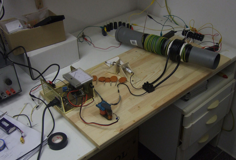

          • 1st time
            Well like this, I quickly threw this together, it looks like too quick.
            FB feels best at 87khz consuming less power and spark gap is working,
            at other frequencies the spark does not work.
            primary 1/4l (2m) 16mm2, secondary4mm2
            unfortunately without effect.
            Well Slovenia I hope you will join together enough brain power to solve the puzzle.
