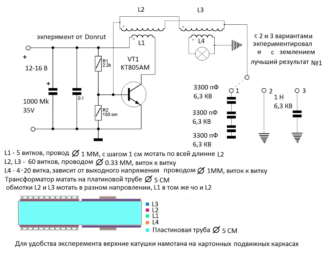

Hi everyone,
I download this circuit from one Lithuanian site. Very simple and easy to build circuit. I have almost 300 Vpp, but no current at all. Frequency is about 2.5 MHz. But I felt something interesting. When I touch one of the coils end, I burn my skin badly. Has anyone of you felt something like that while experimented with Don Smith circuit?
Cheers,
Dragan

1. I'll ask our secretary for translation. It's not to derive from Don's circuit but to learn and find similarities..Originally posted by dragans View PostHi everyone,
Cheers,
Dragan
2. L2/L3 are in fact cw/ccw connected in the middle and outer ends short circuited. My measurament showed that this setup behaves at same resonant frequency like a single cw coil with same count of total windings. In my case both resonated at 1.9 MHz.
3. It reminds on Zilano's three coil setup (middle coil in resonance and short circuited.)
4. The transisor is being controlled by the resonant L2/L3. While the core seems to be ferrite the frequency might be somwere between 20 and 50 KHz. We will know more after translation.
5.Dragen, perhaps you have too high frequency and experience skin effect losses = heat (just an assumption). The wires of 0.3 mm seem to be very thin! Perhaps you destroy your gain producing heat.Last edited by JohnStone; 01-20-2012, 08:10 PM.Experts spend hours a day in order to question their doing while others stopped thinking feeling they were professionals.
