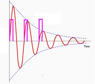

          @John Stone
          regarding 'kick' into system. Last time we agreed, that radiant energy is released during sharp pulse with high voltage gradient.
          To keep system resonating, yes, those kicks must be synchronized with waveform and I don't thing is really necessary to
          shoot pulse in dead point. For testing purposes is much more convenient to sense 'zero' crossing of secondary wave and do proper
          phase shift to shoot another pulse.... See picture. Pulse is fired every cycle only once. This can be hardly done with
          spark gap itself. More accurate timing is necessary and best it jst to synchronize firing pulses with secondary
          momentum, so you get self adjusted resonant circuit, which is the best. If any 'parameter' (L/C) in system will change, driver
          via feedback will follow to keep resonance.Thus controllable sparg gap must be employed. Now I can see, that you've come up
          with same ideas, nice !
          Digital approach: DSP approach or any microprocessor solution is not a problem. I was working on that concept past few days and
          have pretty clear picture. This solution is the best, as you can adjust all parameters and do very precise timing to keep resonance
          at any cost.
          Analog approach: is good too, three comparators, one set/reset circuit and one AND gate will do the job. Idea is to
          sense zero crossing, recognize 'direction' of wave and fire pulse when comparators match. Easy. only concern is feedback sensing
          coil and its signal conditioning. To use it with comparators you need bias input and then process it.
          One comparator will sense zero crossing, one will sense voltage of stepping wave (firing pulse width), and last one direction of wave.
          Set/reset will do blocking in negative quadrants and AND will put fire / blocking together.
          To get precise timing, spark gap must be controlled with trigger. There are two options. To use spark gap with shield (like xenon flash)
          to fire -HV pulse to allow spark jump or jst implement HV IGBT to trigger HV to spark gap. After voltage will be present on electrodes,
          spark will fire.... Solution is easy. Just to assemble it and test. There will be some transition delays, so phase shift possibility
          is crucial to tune whole system.
          I am still thinking about damn spark gap... Its very unreliable component in whole system. If only HV pulse is necessary to trigger
          radiant event (as per discussion before), then HV MOSFET will do the job. I can test 4kV silicon device to fire pulse on exact duty
          cycle and period of course, to the primary coil, but question is.... if spark gap is giving some extra energy to the system or not....
          Zelina said spark gap is the best, but I still don't like that... Why is best ? Because of easy HV handling ? Because of 'magic of the
          spark' ? Who knows.
          I will develop firing circuit to test it. With auto resonance adjustment (based on damped circuit oscillations) and external
          phase / duty cycle control. Duty cycle on spark gap can't be hardly done, but frequency yes... Because of time issues, will do
          it in January.
