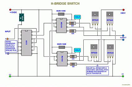

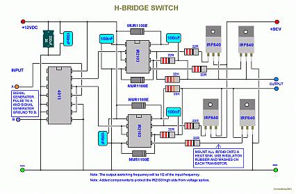

                          For anyone interested, attached is Groundloop's original H-Bridge circuit v2.
                          Also V6 is there and has more protection for the IR2103 but I never built it yet so I don't know how well it works.
                          If you want a larger version, send me an email at : gotoluc@yahoo.com
                          Luc
