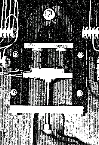

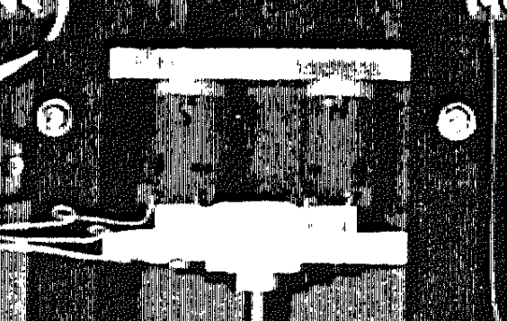

        As far as I know, Mark Hendershot never got the build from which those photos are taken to work.
        I don't know why they are such poor quality. Probably because they are copies of copies of copies. That's the same build as shown in color on the cover of
        1994_-_Extraordinary_Science_-_cut.PDF file.
          Extraordinary Science - Cut.pdf - Marea Sistemi Taken From Mareasistemi.com | Manual Make
          same as this one
          but its not about the copy, all are discuss and studied but with this part of no detailed build and measurement, my poor English
