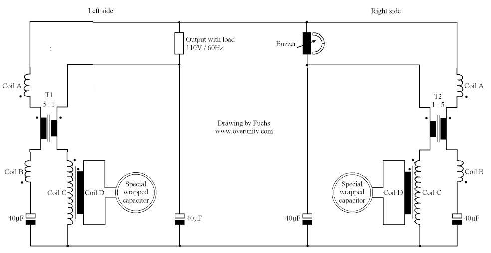

          From these photos, I can draw the following diagram:
          Picture 10
          The circuit reminds me somewhat of the documents published by Skilling and O'Brian diagrams.
          What is new is displaying the handmade capacitors at the PCU's.
          The mass foil and -connections of the former Pyramid TM58 Duo electrolytic capacitors I have drawn in,
          because they are used in this circuit, too.
          All unmodified capacitors have a capacitance of 40μF with 110Volt AC.

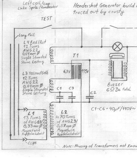

                crusty
                I tried wiring up the "traced out by crusty" circuit.
                See attached.
                My transformer is a 5:1 - not this 115v/6.3v transformer,
                but still, I was curious what would happen.
                I find that with the magnet, I can bring the relay
                down to unbelievably slow frequencies.
                However, there is not much power to the load.
                The neon barely lights when I use a 6v battery
                to drive the relay pulses.
                With a 1.5v battery, neon will not light.
                Also, the oscilloscope shows unimpressive waveforms
                on L2 and L1 ... just voltage spike ... no square wave
                like the other circuit (post #2 above).
                It seems odd to wire the buzzer so that it is NOT attached
                to L2.
                There are other circuits to try
                and I figure by focusing on only the half the circuit,
                I might gain some insights into the full circuit.

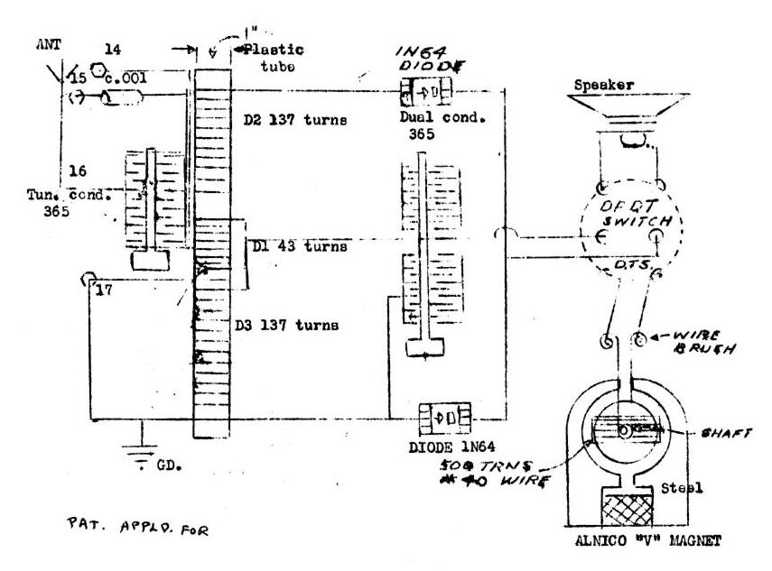

                  In the Barry Hilton book, Appendix B, there is presented
                  the material from "Utility Engines".
                  This is very neat that this was not lost.
                  In the attached circuit, we see a tank circuit on primary side
                  with a 365 pf variable capacitor and a 58 uH coil on a 1 inch plastic
                  pipe. I calculate that this would tune frequencies in the range of
                  1 Mhz to 5 Mhz (when the 1nF by-pass cap is not connected).

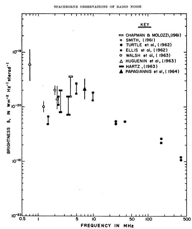

                  In the other attached image is a table from data
                  obtained from this article.
                  1965IAUS...23..309H Page 309
                  The interesting feature of this circuit is that there are two
                  secondary coils wired on either side of the primary coil
                  and the turn ratio is about 3.18 greater on either side -- if
                  we think of them as a transformer.
                  On this secondary side is a dual 365 pF variable capacitor
                  and some germanium diodes forming two half-wave
                  rectifiers -- wired ored -- to produce a full-wave rectification.
