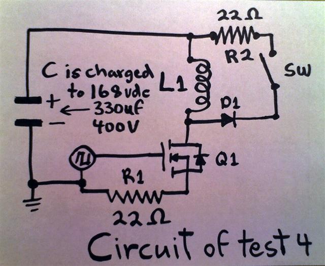

    GOTOLUC,
    could you post a schematic for the tests where youre using the 555 circuit, as im having difficulty splitting the power supply for the 555 circuit while upping the power for the coil, i cant quite understand how youve got 170VDC or so going into the coil while only having a low voltage for the 555 circuit.
    I dont need the circuitry for the 555 control, just the power connections etc.
    David. D
    • #92
      help!
      GOTO,
      im tearing my hair out trying to figure out how to put 170VDC to the coil, and yet only have an approriate amount of V going to the 555 part of the circuit.
      How did you do it?
      David. D
      • #93
        I believe he rectified 120AC to get 170v and used a seperate power supply for the 555.

                Hi David,
                I see your post and I'm looking to see if I can find the 555 PWM circuit that I'm using.
                I'll post something soon
                Luc
                • #98
                  Originally posted by rave154 View Post
                  GOTO,
                  How did you do it?
                  David. D
                  David, are you using a mosfet on the high voltage side? The 555 is only used to trigger the mosfet (not the coil) which connect the negative of the high voltage to the coil. The coil positive should not be going in the 555 circuit.
                  See my circuit.
                  Luc
                  • #99
                    GOTO,
                    if i understand you correctly then..
                    then 555 circuit has say a 12VDC source....and the mosfet/coil has a higher (170V) DC source, with a common ground?
                    David.D
                    • GOTO, in other words,
                      the lil "pulse symbol" in the circle represents the 555 circuit AND its own power supply with a common ground to the HV ground of the cap?
                      • GOTO & others,
                        i have successfully implemented your circuit ( the one with the HV cap as the source for the coil ) together with a small 9V source for the 555 side. i'm using 3 x 12VDC batts in series for the coil side power supply.
                        i just connected the small DC motor in place of the "output" bulb WITHOUT a cao like you suggested and it runs !!!...pretty fast, not full speed for sure, but not slow either...all of this is with the "input bulb" not even glowing at all ( by careful adjustment of freq & duty cycle )
                        how very "entertaining" !!!!!!!!!!!
                        David. D
