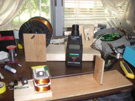

              Gonna try to send a picture of my Keppe motor. You may notice that I plagiarized gmeast's winder for this motor. Thanks gmeast .
              Later,
              Carl

                Hi Spearmaster,
                Ah yes! The winder is a very worthwhile effort. It probably didn't take you long to build it either but certainly saves time and makes a neater job. I see I was still lazier though by adding the counter. There's no way I could have kept track of 500 turns per stator half. At first I was going to do it by weight, but I sprung for the $32.00 counter instead.
                Nice work.
                Thanks for sharing,
                Greg
