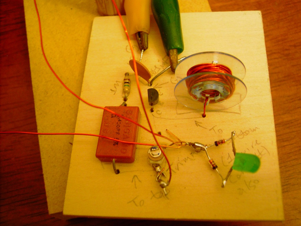

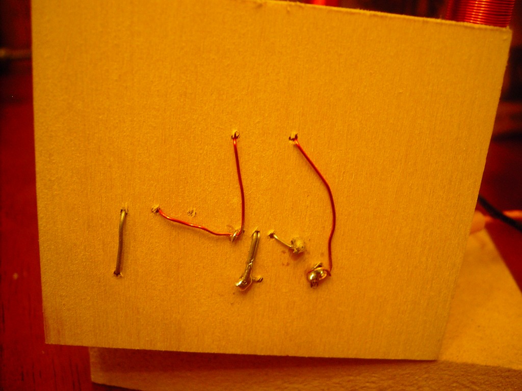

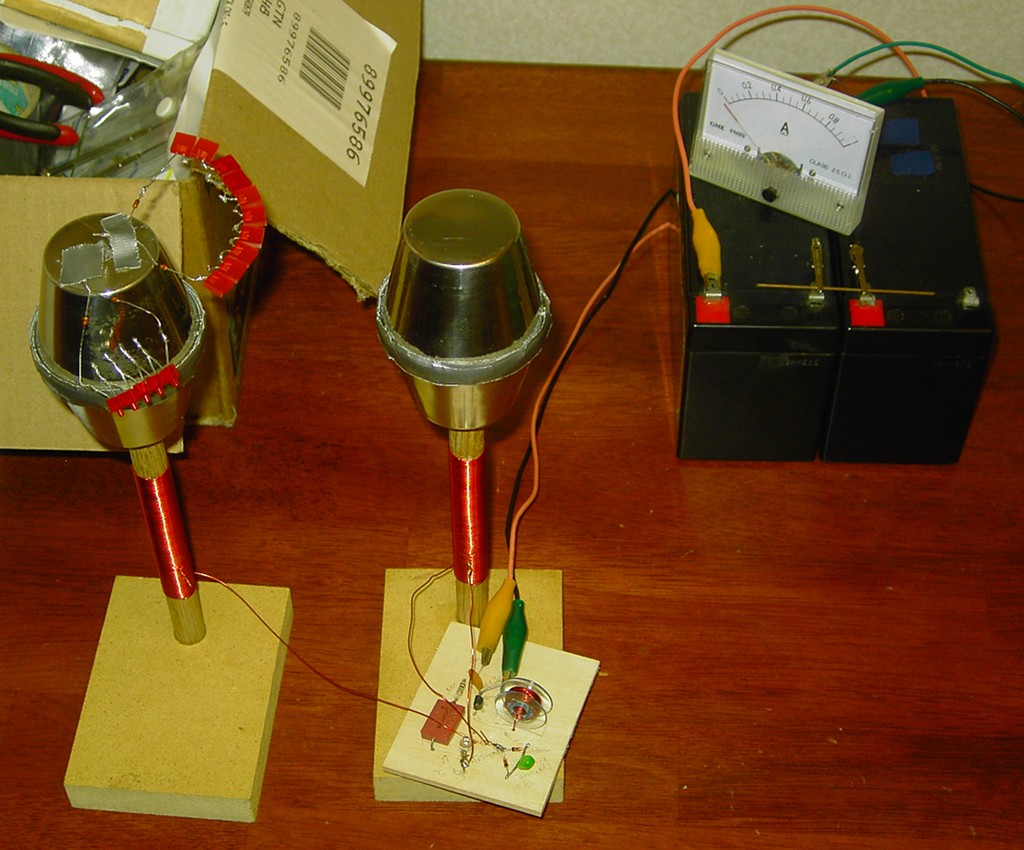

                No, not a surgeon. And the thing will only bite if you have very light pressure on the transmitter hat--just barely touching it. With normal pressure you feel nothing, but the LEDs light up nicely. I found this out when trying to see if it was the pressure of my finger on the hat making it work, seeing if I could gradually remove my finger and leave the LEDs lit.
                I do have a bunch of NE-2s in my parts box, I'll have to give that a try.
                At any rate, here are the pictures of the thing. Let me know if there's any other information/pictures you'd like to see. I should point out that there's a LED on an AV plug coming from the 1-wire connection to help with tuning; also the 1-wire connection to the receiver tower is not soldered. That will be dealt with once I get some of those solderless connectors.

                  @Shamus
                  Just throwing things out here that are quick to try.
                  Well, yes you are short on capacity (parasitic). Maybe a fast way to get it going is to connect a lead from the battery -V to earth ground. The service ground would be fine (not the Neutral). My second worry is the LED's, seems I had a bunch of the small guys and they took a tone of energy to light (may be wrong here) but I would just start with one larger White or Red LED. The Red will fire at around 1.7->2V and the White from 3.2->3.7.
                  Now I would first disconnect the second tower, just connect the bottom of the one tower to the collector of the exciter, try this. Now add the earth ground and try again, if still no go place a paper or cardboard between the exciter and a piece of Al. If you still can't get it going move the ground to the Al plate.
                  Now what is the value of that trimmer? Maybe adding 20-30pF will solve some tuning issues.
                  Good Luck and keep me posted.
