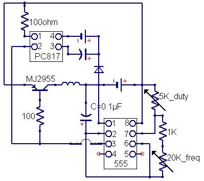

    Maybe, but I don't think I can measure it. If the signal from OFF to ON is important for this maybe we should see the spec of rise time. Here is what I found out:
    PC817 optocoupler rise time = 18 micro second max
    CEF02N6 MOSFET rise time = 35 nano second max
    But would faster rise time is more important than more high voltage exposure in battery charging?
    edit, important fix for latest circuit.
    change the cap to battery to become negative polarity switching conforming Bedini switcher.
    and fix the resistor place.
    Second day experiment do not show self charging effect.

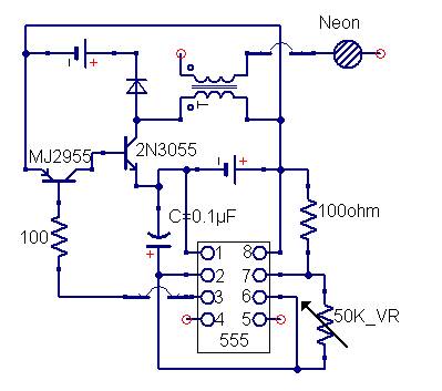

    • #32
      Another circuit fix
      I still don't get LM393 yet but want to use the the coil in positive part like Bedini mention. Instead of triggering only 2N3055, I use MJ2955 to trigger the 2N3055. This way I can get very short on time for 2N3055 by utilizing short off time of 555. This way I hope I don't experience hot transistor and transformer again.
      Modification now comform with Bedini style, coil collapse by switching of negative side of coil and battery charged by switching negative side of capacitor.
      Charging is faster than when coil is negative part.
      Test report today:
      before turn off:
      battery = 9.63V
      capacitor = 12.24V average
      source = 11.08V
      after turning off
      battery = 9.49V
      capacitor = 11.98V
      Eidt:
      This circuit turn out to be much better than my previous setup in heating property. This circuit transformer and transistor will not heat as fast or as much as previous circuit. Only the resistor and optocoupler that heating up, but this can be solved by using 2 watt resistor and adding heatsink to optocoupler.
      Without capacitor, the battery would charge up faster but the transistor would get very hot even with heatsink, and transformer get hot to the point of it become untouchable.
      The very short pulse of the activating pulse also make the operation a lot cooler.

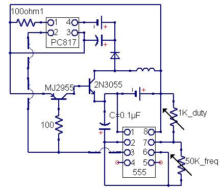

            • #36
              The best depend on what you want to achieve. The one that I currently use are attached. The reason for this kind of combination (555, NPN and PNP) is:
              - I want to achieve 0 to 50% duty cycle using 555 (said to be colder)
              - I want to switch off the current using NPN (said to be most efficient)
              - 2955 and 3055 usually sold in pair here
              Don't expect to get overunity with Bedini charger. Even Bedini himself mention that this kind of circuit is not meant to achieve overunity. The solid proof way to achieve overunity still not published yet. Using capacitor may help, but it is not the kind of capacitor we can get at store. Same with coil, transistor, etc.
              When using capacitor for charging, you need big capacitor. The electricity generated when the current of a coil being switched off is collected in the capacitor. Once the capacitor is twice the charged battery voltage, it then be used to charge the battery. The problem is the switching mechanism. Relay is too slow and using optocoupler is less efficient (hot). I found that charging using direct way using my attached circuit is much faster and have higher charge.
              I conclude that capacitor charging is less efficient than direct way for my kind of implementation.
              When you switch off the current of a coil you get radiant electricity. But to get usefull charge you need current. High current can be achieve by using coil with low resistance or power source with high voltage. But high current may kill the transistor and 555 if you are not carefull. I use 11.5 Volts power source and my coil around 9 ohm (just from memory).
