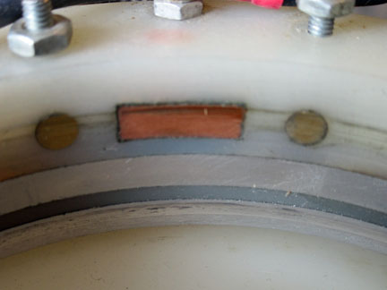

            • Detail of the E-5 Pulse Motor Commutator
              Dear Nat,
              Concerning those 12 round contacts on the E-5 "White" Pulse Motor. Here is a recent clcose up photo of what I was refering to. There are 12 of the 0.250" brass contacts equally spaced around the inside of this commutator system. There are three of the rectangular copper contacts.
              The brass contacts seem to pre-charge the main storage capacitor bank from a smaller bank. For this to work the voltage on the first bank has to be higher than the collected charge on the main bank. Perhaps this was done for isolation purposes - I don't know. However Ignitrons were employed to make this transfer.
              The copper contacts are used to trigger the main power Ignitrons. This dumped the charge from the main storage capacitors through the opposing electromagnets.
              Now, keep in mind that this is early technology from a Pulse Motor and not the technology that was used in the Free Energy Engines. However they are very similar.
              Mark Mckay

                          Is that an aluminum ring on the commutator?. So we have brass & aluminum? and carbon brushes
                          Nat
                          • "White" Pulse Motor (E-5) Commutator Details
                            Dear Nat,
                            Yep, not only one aluminum commutator ring but two (2) side by side. So there are two rotary switch systems combined into this device. However they do share the same wiper.
                            When Nelson Schlaft rewired this system he didn't need the 2nd common slip ring and removed the wires that were attached to it. So we have no idea as to what they were controlling. I would venture to say that one slip ring was associated with the 12 each round contacts intended to pre-charge the main storage capacitor. The other slip ring was part of the main discharge control system. Since two switching systems were involved two slip rings were needed. If isolation was an issue then by rights the wipers should have been separated as well, but they are not.
                            There are two more slip ring assemblies in these E series Pulse Motors. One is at the front of the motor just behind the commutator and another is at the back end of the motor. These slip ring assemblies are odd in their construction since the brush is on the rotor and the slip ring is fixed. In every other industrial motor I know of it is the other way around. This layout allows easy replacement of the contact brush. Why Mr. Cole did it this way is unknown to me. The only proposal I have heard is that this kind of arrangement works better for high voltage, but you have to completely remove the rotor shaft to get at the brushes, which would be a real pain once the engine was installed. IF this proposal is correct then the expected voltages were much higher than 5 kV. The 2500 HP DC motors used at our local aluminum rolling mill operate at 2675 DC and use the common brush to slip ring method just fine.
                            Aluminum is a poor choice for a slip ring surface - in my opinion. I have never seen it used in industry. Special alloys of brass are the preferred materials along with Beryllium copper - which seemed to have been used in the commutator contacts. Perhaps cost and availability were issues at the time.
                            These commutator systems hold a lot of hints. They point to the large number of state changes required in this technology to yield the huge COP's
                            Mark McKay

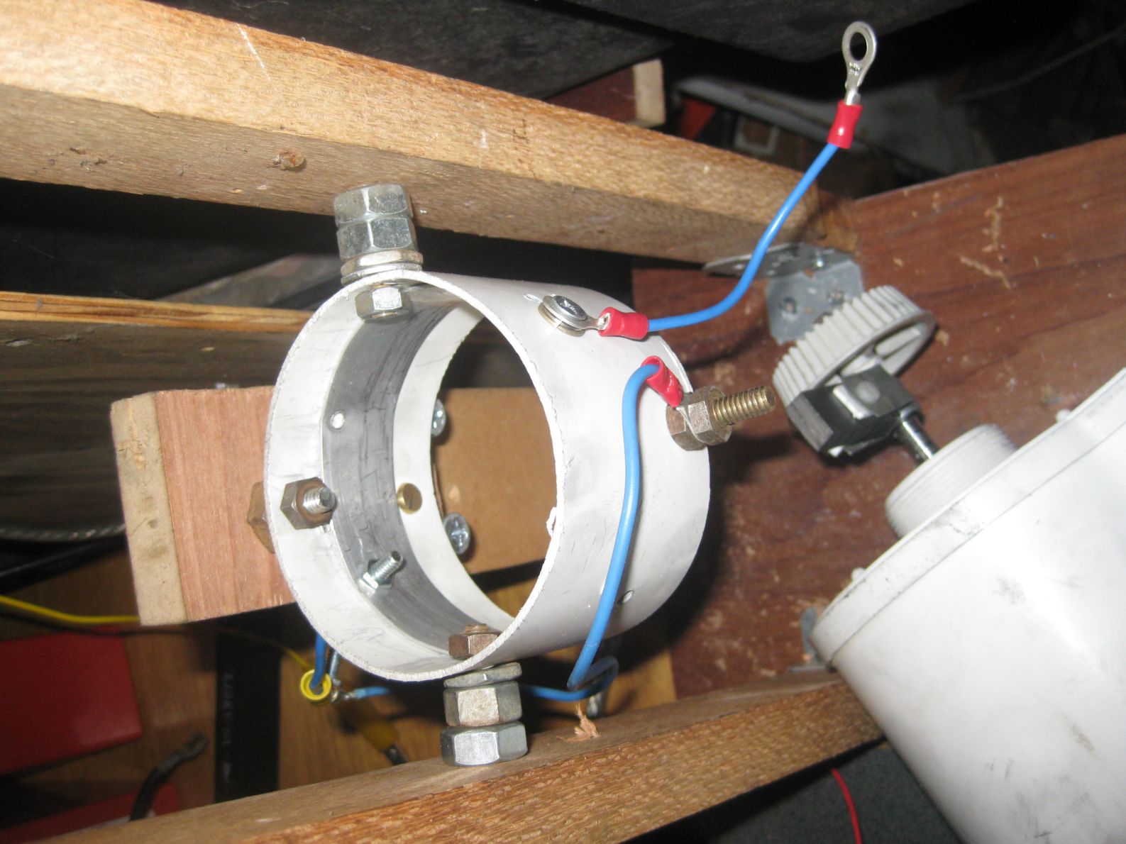

                            • mark,
                              l will build a commutator using the same metals and see if there is some special unknown feature - it wont be exactly the same but should provide some insight - i have been wondering whether the aluminum ring is important too. I suspect there must be as Gray's circuit has way to many features of Tesla's circuits.
                              Did you receive my email?
                              Nat
                              • ok so hears a photo of my very rough and ready commutator. Interesting enough when i checked the resistance when engaged i got 30 ohms. Makes me wonder if the spark is getting choked somehow in the metallic lattice.
                                Still untested yet. I will be happy if i get a couple of test runs out of it before it stops working.
                                After building it i now realise the extreme precision that has gone into it.
                                cheers
                                N.
