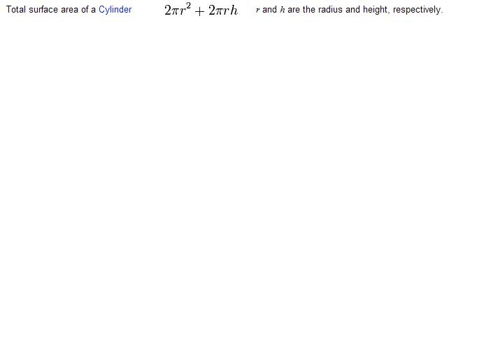

    Hey Rick,
    The quickest formula I could set my hands on for you that I use is -
    Area - Wikipedia, the free encyclopedia
    The formula is for a cylinder or tube (exterior) -
    2 x Pi x r2 + 2 x Pi x r x h
    Tubing - .250 od x .125 id (.125 r x .0625 r)
    OD - .098 + .785 = .883 sq.in.
    ID - .024 + .392 = .416 sq.in
    (OD + ID) .883 + .416 = 1.299 sq.in. Total
    Wire - .077 dia. x 7 (strands) #4AWG CU WIRE "95 amps" NOTE-(AWG cir.mil. "is" AWG cir.mil. regardless of strand qty.)
    .009 + .238 = .247 sq.in. (1-strand)
    .247 x 7 (strands) = 1.729 sq.in.
    1.729 Wire sq.in.
    1.299 Tube sq.in.
    .430 sq.in smaller the tube is
    I'm sure this is the correct formula, radius squared not diameter ?
    Glen

                        Reply to Glen
                        Glen wrote, " I'm sure this is the correct formula, radius squared not diameter?"
                        Sorry Glen, but no. The formula you are using is for a solid cylinder, and figures the total surface area of all geometrically exposed surfaces, including the surface of the 2 ends of the cylinder. The area of each end would be 3.143 x the radius squared, and thus your formula states 2x that amount to include both ends. The ends don't even come into consideration when figuring surface area of battery cables, because the cable terminates on the outer surface at a cable clamp or ring terminal. So you need to simply figure the lateral surface area, which your Wikipedia source will show as 2 x Pi x radius x height, and that's exactly the same as figuring the more simply stated Pi x diameter x height. In other words, Pi x diameter = 2 x Pi x radius. Same thing - just remember to drop the first half of your formula when calculating the lateral surface area. Sorry that I figured for a 1/8" copper tube when you were actually talking about a 1/4" tube (I had the spark tubes in mind at that moment), but just plug the correct values in and here's what you get for 1/4" copper tubing : (s.a. = surface area)
                        Outside s.a. = 3.143 x .250" x 1" height = 0.786 sq inches, rounded up.
                        Inside s.a. = 3.143 x .125" x 1" height = 0.393 sq inches, rounded up.
                        Total s.a. = .786 + .393, or 1.179 sq inches.
                        Before, I thought we were comparing the surface area of a solid conductor to a tube. Stranded wire figures differently, of course. For the wire, if I understand you correctly, you are saying that a 7 stranded cable with an outside diameter being approximately the same as the outside diameter of a 1/4 inch tube, has 7 strands inside - each with a .077" diameter. Okay, then figuring one strand's lateral surface area, the formula for surface area is:
                        Outside s.a. for 1 strand = Pi x .077" x 1" height = 0.242 sq inches.
                        And total s.a. for cable = .242 x 7, or 1.694 sq inches.
                        So yes, the stranded wire cable actually has more surface area, and 0.515 square inches more, to be exact. The question here, though, is: Can the 1/4inch diameter stranded wire cable transfer more power faster than the the 1/4 inch tubing, and the answer is - definitely not. Here's why:
                        We both agree that current tends to travel near the surface of a wire, and that this is termed skin effect, right? Skin effect results in increased power loss in a solid wire, and that is what each of the strands is - a solid wire. According to Wikipedia, "Stranded wire might seem to reduce this [skin] effect, since the total surface area of the strands is greater than the surface area of the equivalent solid wire, but in fact a simple stranded wire will have worse skin effect than a solid wire, because of its increased average resistivity due to inclusion of air gaps within the wire [bundle]." In bundled, stranded wire cables, the skin effect still occurs mostly near the outer suface area of the bundle. So, in other words, the power transmission of a stranded cable is actually poorer than a solid cable. Stranded cables are only popular because of the fact that they can be bent and routed much more easily than solid wire, but solid wire is preferable where power transmission losses are concerned. That's why your household wiring uses solid copper wires. It reduces power loss and heat buildup that would occur in stranded wire. With a tube, you can take an increased advantage of the skin effect due to the inside surface, and both surfaces have very low resistance when compared to stranded wire.
                        Again, sorry if my previous post on the math confused you because of figuring a different cable size. Actually, I made an error on my calculator (my eyes are getting bad), figuring the outer surface area of a 1/8" tube at 0.427 sq inches, when it is actually 0.393. I went back and fixed that, so the end result is now correct, but the basic formulas used were always correct, as I have shown above. Incidentally, while the previous error resulted in a 47% increase using the tube vs a solid cable, the actual increase is 58.5% - even better! The tubing wins, hands down, thumbs up.
