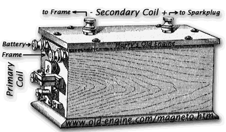

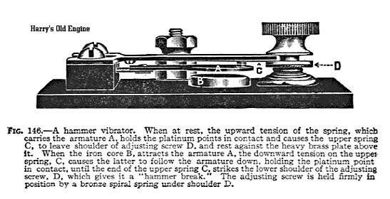

                        I was looking at something similar to you, some months ago and found some old car devices that even I had never heard of, called 'BUZZ COILS'.
                        Look at these great examples:
                        "See additional notes that follow in the summary section. You can make your own BUZZ COIL from easily obtained parts by visiting this link. This method using modern parts, has separate coils - one for stepping up the voltage to feed the spark plug and one to act as the "interrupter" changing the DC battery voltage to pulsating AC."
                        visit website here:
                        Magneto Ignition for Gas Engines - Buzz Coils
