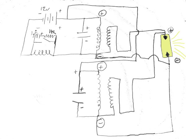

                  See amended schematic:
                  I think the relay is becoming hot because it is getting some of the feedback voltage from the coils.. I was not charging batteries with the feedback so this could be why.. I will try with batteries being charged to see if it makes a difference.

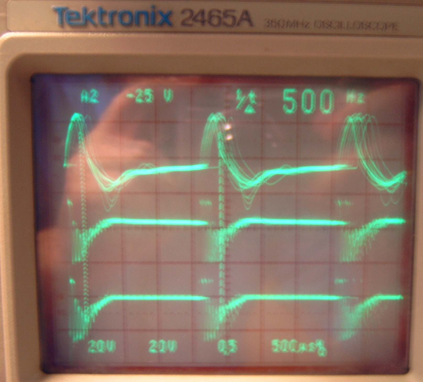

                  • My scope shots
                    Sadly my ordinary work does not allow me the time I would like to spend on this exiting experiment. I did this some days ago, sorry for not reporting at once.
                    I also used a neo to try tuning the frequency, by got no further than 350 Hz.
                    I then changed the bias of the springs, and restricted the movement of the vibrating part of the magnetic circuit, then I got up to 500 Hz.
                    I cannot reach the very nice brightness that waterhouse24 demonstrates , but the 500 Hz resulted in my best brightness so far and as a bonus the current dropped from 800mA. it now was running at 4.1V 650mA = 2.7W. Further adjustment got a little higher frequency, and the current dropped to 400mA but the brightness dropped also. Now the high voltage was close to sine shape, but before I got a picture the relay gave up.
                    It got so hot that the contact arm lost its strength and bent nearly 90 degrees, the contacts also looks more burnt than seen before.
                    I wonder whether the contacts just got its share of wear, or the resonance was the cause of death. My power supply was restricting the current to 2 Amps.
                    In my attached pictures 3 traces are seen. The top is from a high voltage probe 1000:1.
                    at scope .5v that gives 500V/division. There is no difference in brightness whether the probe is connected or not.
                    Previously i made a high voltage 400 kHz flyback supply. Then the probe draw a small arch when connected. But with this circuit this was no problem.
                    The middle trace is the voltage across the primary coil, 20V/div. The bottom trace is the voltage across the contacts, also 20V/div.
                    Scope ground is connected to coil negative. All traces have zero at a division line.
                    Note that for 1 ms each pulse current is just wasted, as the voltage across the primary is constant 4.1 V. So a solid state circuit could nearly double the frequency to raise the brightness by increasing the time high voltage is present.
                    I also wonder whether another design of the coil could be more efficient, if the high frequency oscillations on the primary could join making HV. In other words get another relation between primary and secondary resonance..
                    My home made Ignition coil is seen also with the welding rods added.I dusted off my old analog meter to get a more reliable reading of the current.
                    The last picture shows the recovery charging pulse to a 12V lead acid battery. Its duration is remarkably long compared to my SS charger. It raised the voltage of the battery. but the relay life did not allow for testing the efficiency.

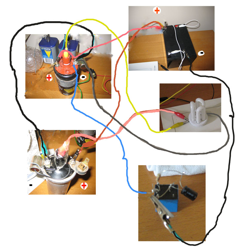

                                Hope this helps someone.. just a photo diagram of the setup:
