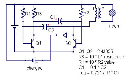

          • Alternative solid state idea?
            I came accross multivibrator transistor at techlib.com and inspired by gmeast post at water spark plug page 71. Anyone ever use 2N3055 as flip flop and dump the waste as charger?
            Will the circuit attached bellow work?
            edit:
            fixed the capacitor and freq calc
            For car coil application, there is example of loading only one transistor where it has much lower resistor value, as long as R1*C1 = R2*C2.
            • Flip flop 2n3055
              I made that exact circuit once in attempt to oscillate centre tapped transformer, secondary to bridge rectifier for high voltage. That's before I knew you need kilovolts to get a spark and that's when I found imhotep's videos re ignition coil.
              So, the circuit works. I later stripped it for the parts, never tried to dump to a battery.

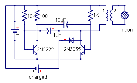

                      @Inquorate, thanks. I'll see if I can find that transistor here. Would TIP3055 better than 2N3055? what is the function of wire wound resistor?
                      @Lidmotor, that is interesting. It seems the current version of ambient power work best as battery charger.
                      I decide to build the device and test it. The component value are in attachment. I don't have two 2N3055 so I decide to use 2N2222 for replacement. I use transformer instead of coil.
                      It works, but only for 10 seconds . In that 10 second the transformer make buzzing noise and goes louder and louder and then stop. The neon light is lighten up dimly during that time.
                      Now I have to figure out which part is broken before I can continue. Anyone know how to find out wether the transistor is broken or not?
                      • Replication video
                        Still figuring out what is wrong with my implementation here is a replication of slightly modified Imhotep Radiant Oscillator. Instead of dumping the induction to source positive, I dump it to source negative, like the diagram I posted previously(http://www.energeticforum.com/renewa...tml#post40668). I dump it to a HHO generator miniature.
                        Using computer power supply, the voltage is 12V, the current is 0.09Amp .I wonder if this reading are valid, measured from source negative. Transformer 12V primary and 240V secondary is used. The neon is taken from 8 watt CFL.
                        The neon light up about half it's original. It light up brighter than original using 6V primary, but my power supply can only run it for a second before it shut it self. Maybe because the power supply almost reach it's end of life or the amp draw significantly higher than it's reading.............
                        Video:
                        YouTube - Neon driver using Imhotep circuit, 90mA !
                        • Lab pc power supply
                          @Sucahyo - re transistors, I haven't used Tip3055's before. If they can handle high amps and high voltage like the 2n3055's I'd say they'd be ok..
                          A pc power supply will auto shut off unless it is tricked into thinking it is running a computer. Details on how to re-wire it are here:
                          How to Convert a Computer ATX Power Supply to a Lab Power Supply - wikiHow
                          Wire - wound resistors.. I just used them on a whim :-)
                          Could be you fried the 2n2222's on your circuit from the back emf / voltage spikes from your transformer. Ps some transformers just hum, imo. I have one that does.
