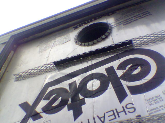

              Well I had a slight disaster when removing the collector sheet.
              I bumped into-tripped over the dish uplink and killed my high speed inet
              so it took awhile to have the time to send these pics using dialup.
              but here they are...
              The collector sheet is aluminum anodized and has this convex pattern.
              there is the top vent that goes into the house.

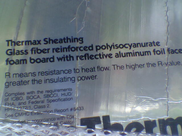

              there is a pic of the damaged sides that I need to seal up.
              and the type of insulboard that they used to make the unit, fiberized foam foil-backed.
