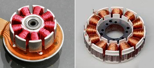

you will find 4 pole winding data on this link "YouTube - Free energy - Bi-Filiar winding for Bedini Imhotep Fan" good luck ,the video uses an 8 pole rotor for illustration and depending on the magnetic structure of the motor i don't see why you could not use the same pattern all the way around any stator. give it a try and see if it spins up .Originally posted by yx630514 View PostHello everybody
I have a 9 pole and 12 pole, can it? Effect may be better? By the way how the wind?
Xu Yuan
