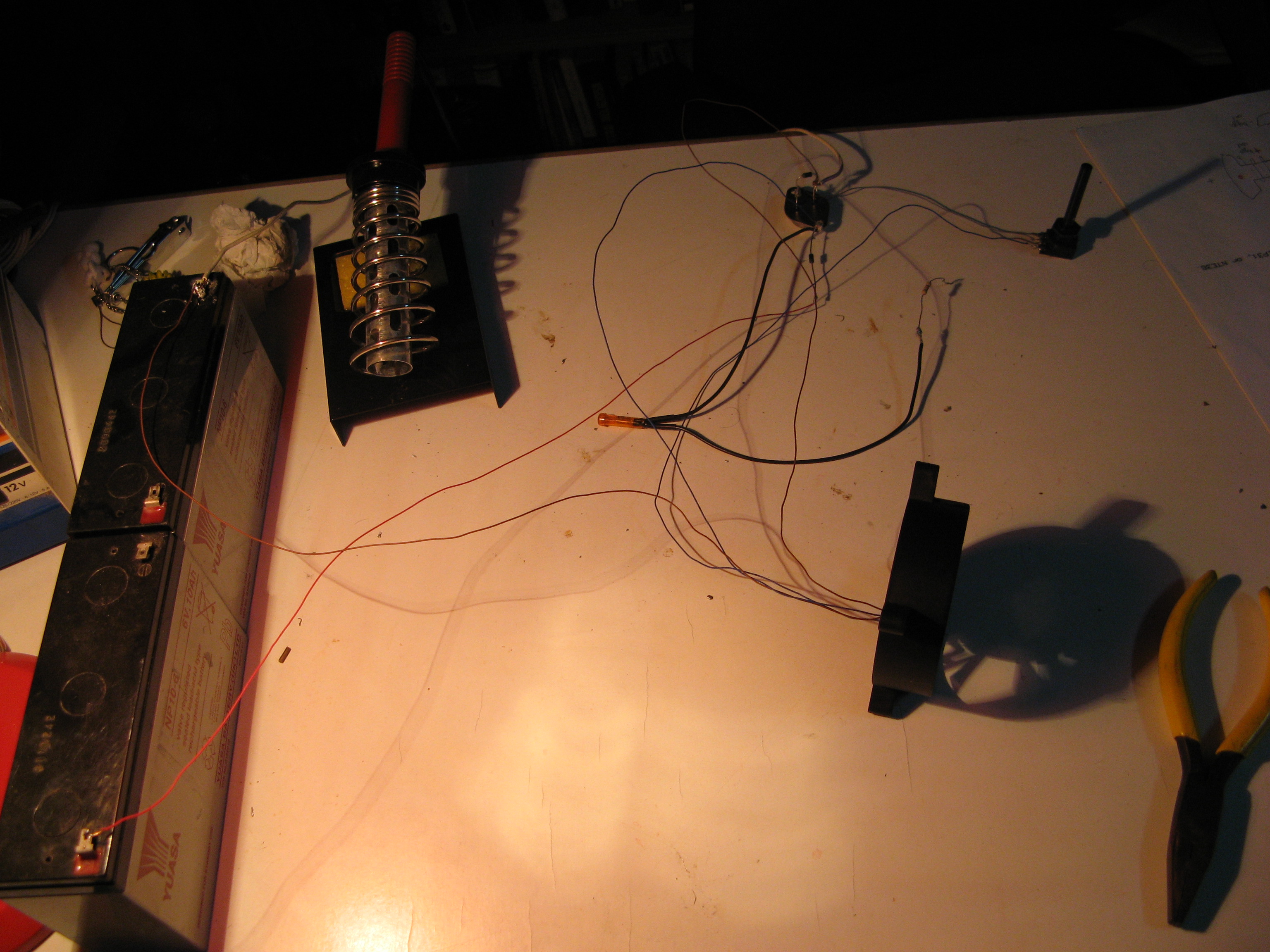

So, finally I managed to complete my circuit, but it doesn't work. Can't figure out why. All connections is ok, diodes is in right direction, 2N3055 is functional and connected as well. Variable resistor configured to 2 Kohm. Only neon is ~ 60V AC rated, because thought that firs time I won't be able to get spikes as high as 100V. And I was true. Couldn't get any spikes at all...
I have two thoughts. First - it could be that my PC fan rotor magnets are too weak to trigger transistor. Tried to measure induced voltage when spinning fan with my hand, couldn't get more than 30 mV.
But that could as well not be the case, because my multimeter may not show the initial voltage spike.
Second - maybe I didn't understand fan wiring after all? I connected it so when both coils are connected to + and - PSU terminals. And my magnet indicated that the stator coils showed NSNS configuration. Isn't that right?
Btw, coils are wired cw-ccw-cw-ccw, they are bifilar, each wiring has 7 ohm DC resistance, bifilar together - twice as low, two coils together - twice as much and so on.Originally posted by Tehnoman View Post[..]

Well, I used existing configuration, I had to rewind only one of them, because I couldn't get out one end of wires. The wire itself is small as hell, I haven't got smaller in my home, that is for sure.
Lenght of wires was ~7 m each (bifilar winding). More wire wouldn't fit in. Tomorrow I'll try to change my rotor, I have second fan (the same model). If that won't help, will try to find other fan.

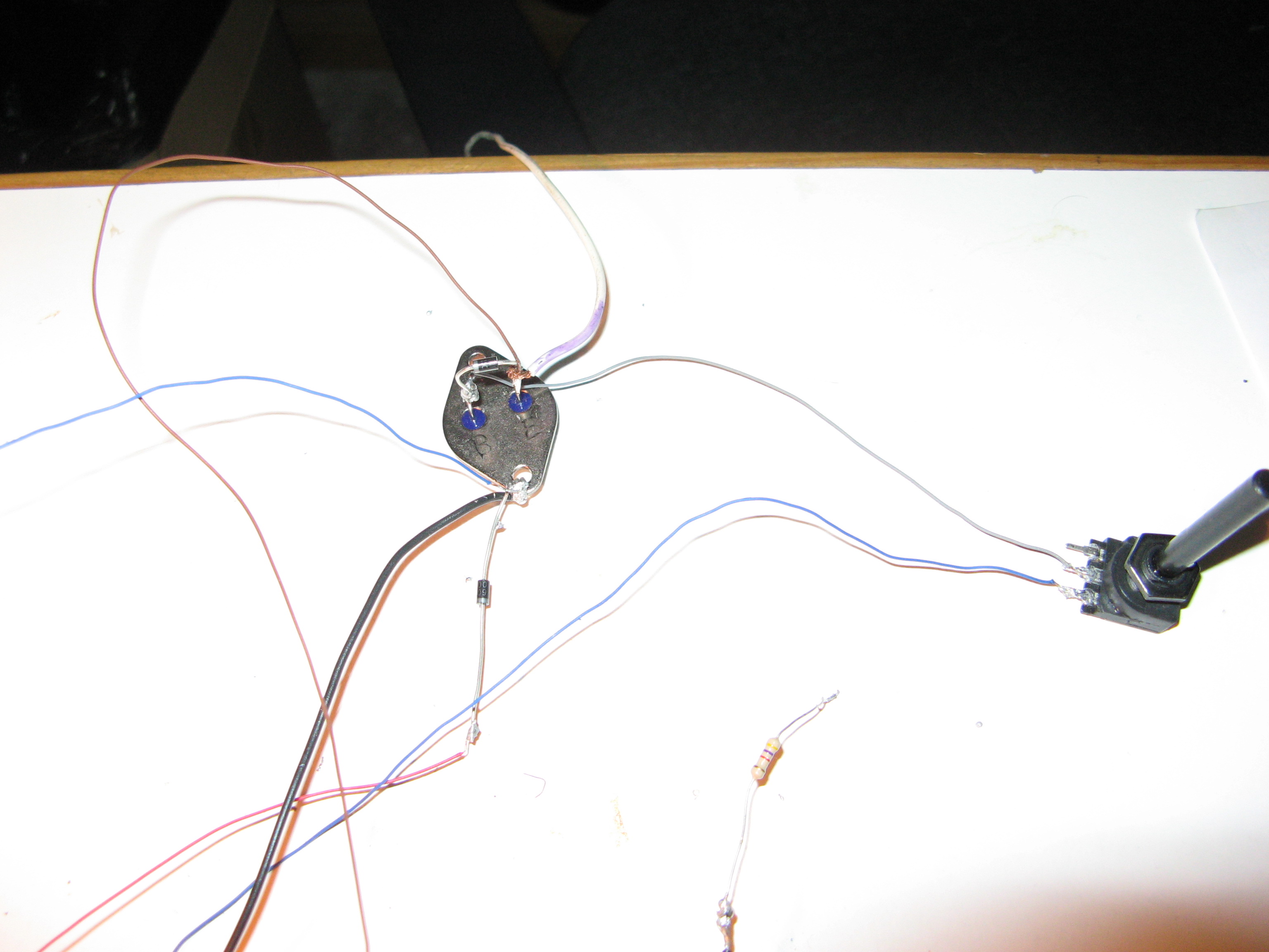

First I have measured the continuity of the coils (40-50) each pair. Then I choose one continuity as a trigger coil (in my case blue wire), one side positive, the other side negative. I connected one side to the potentiometer and the other in the collector. The other pair of coils (brown wire) I've connected one to the positive of the source and the other to the negative (emitter of the transistor). Then I turned on the source, and my fan at 2k has a contrary force if I try to turn during quarter round and correct force if the other quarter of the round. I've tried many fans and all work same way...I don't know where I'm wrong. I tried interchanging the blue wires to change the direction of the current. Nothing change...
I may have hooked wrong the circuit...now I don't know what's happening. If I don't find the solution I'll try to wind the coils by myself.

ok at the power coil hookup and the trigger coil hookup exactly .
you have it miss wired change your wiring and you should be successful one side of trigger to POT other side to EMITTER one side of coil for power to COLLECTOR and other side to B+

Got it working!!!
There was two things.
1) About DC resistance - true, previously I had connected bifilar windings parallel, that means - lower DC resistance and possible higher current flow. Don't know, why I did it, but I was wrong. Reconnected wirings in series, got 4x initial DC resistance and at least some neon activity, when I spin the fan. But that was not the whole story.
2) My rotor magnetic accidentally got messed up, when I tried to find out magnetic configuration. That was because I used too strong magnet too close to rotor, to see the N-S configuration. Have absolutely no idea, why.. Changed the rotor to identical one from my other fan and spinning went off.
So far looks good. Sounds a little bit strange, but current draw is nice and low... Between 50 and 120 mA.
Will try to post some pictures and maybe video of my device tomorrow.
P.S. Wire bifilar coils in series and don't stick too powerful (neodymium as in my case) magnets to [not stator] rotor (sorry, fast typing mistake). Will mess things up.

I've fullfil this working...but I'm not sure properly. First of all I use a 12V (actually mesured 16 V) power supply when I turn on the fan giving a little force to turn begin to turn a rarely low rpm's. Then the strange thing is that I wait 60-100V between emisor collector and there are 12V. Maybe is because I don't use an scope and I'm using a multimeter, could be...? My charge battery is charging but very slow. Also when I tried to change my power supply for a conventional battery seems that is working but the fan stops (maybe because needs more power? the battery is around 10V). Don't know what's happening...some help?Originally posted by **~Imhotep~** View Post
