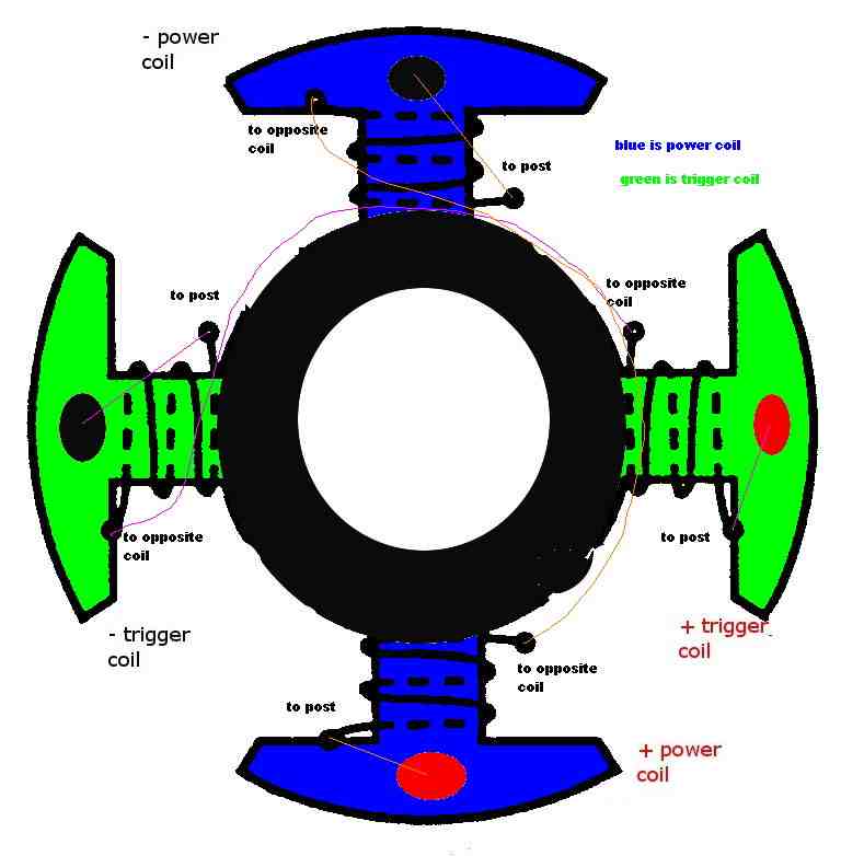

The fan coils are all the same layout (7 different fans).
The coils opposite each other are connected on each side.
So if this is your layout
1 2
3 4
1 and 4 are connected, 2 and 3 are connected.
Perhaps that is the problem, however all fans I have checked are wired this way.
Are the coils adjacent to each other supposed to be connected?
That would certainly explain it.
I would love to see a written parts list of what parts are known to work, written instructions for assembly, and a diagram of how the coils are supposed to be wound and interconnected.
Something like what santhony posted (only I'm pretty sure they aren't all supposed to be connected as in his diagram).
I have it working now.
Since my coils are connected
12
34
1 and 4, 2 and 3, I put 2(+) on the + supply and 3(-) on the collector, 1(-)on the pot-base, and 4(+) on the emitter.
It all comes down to coil layout, which is why a set of detailed diagrams for each possible fan coil config folks have come across would be very useful.
I used 12V 700ma supply, NTE125 diodes, 2N3055 transistor, 10Kohm wire-wound linear taper 10-turn pot, and a Delta AFB1212HE fan.
I edited Imhotep's stator to show how mine looks, and where the wires run.
I'm ready to try some recharging now.
