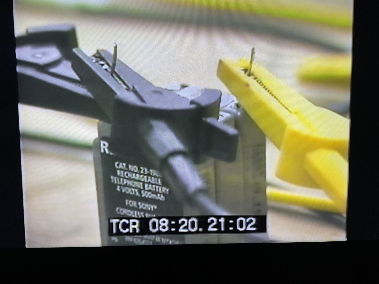

      Each battery is 4volts at 500 mAh, three batteries in series and each battery is 12 volts / 500 mAh.

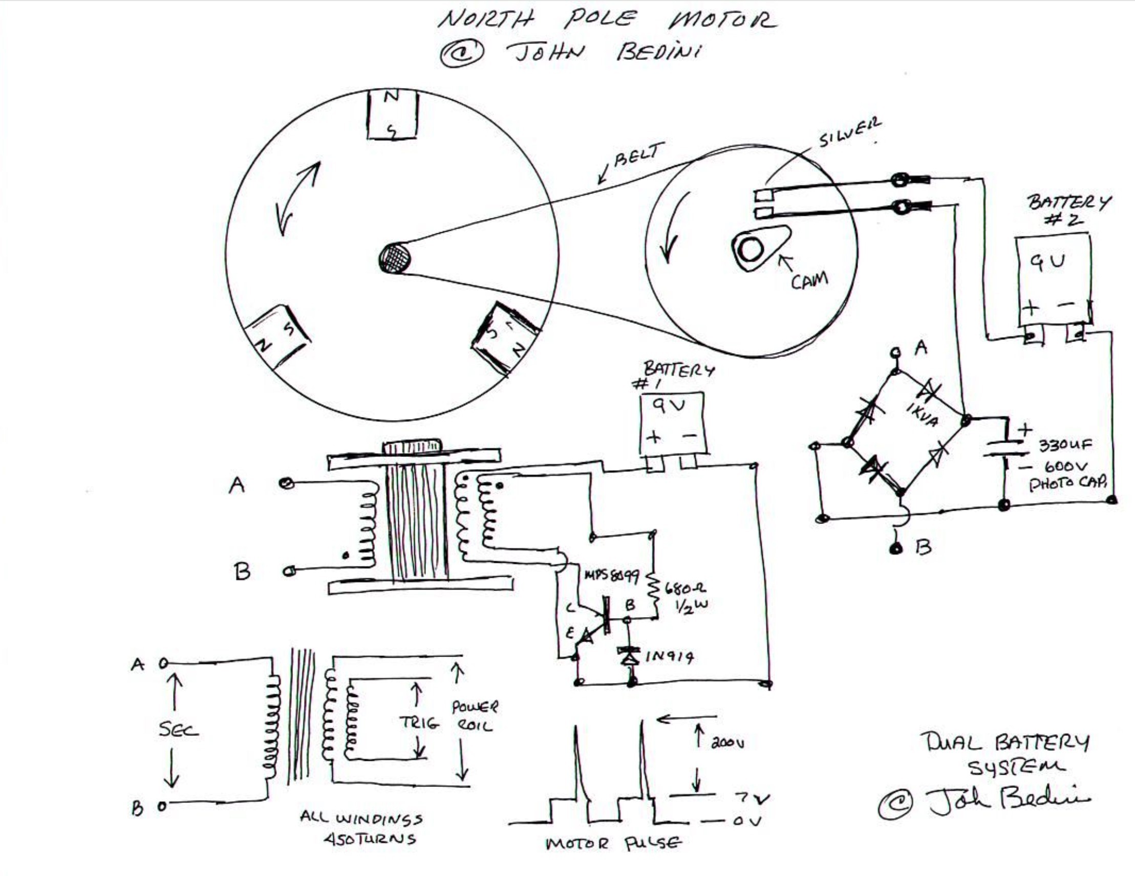

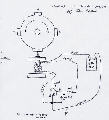

                These are the 3 schematics he posted in Keeleynet years ago after Jeane Manning had her article on the Schoolgirl motor published.
                The Dual Battery System (I was calling Dual Battery Charger) is 100% identical in principle to the SG John was using.

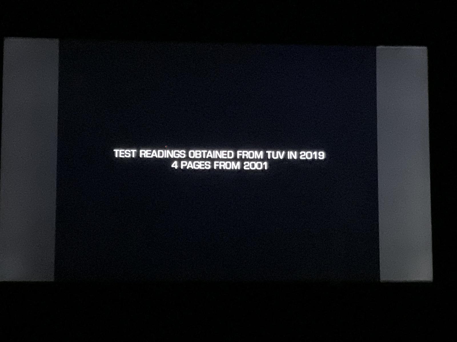

                        thanks for the schematics and the video snips. very interesting. At he end of the second video they say that in 2019 they got a hold of Haensel and got the complete reports, and that they're included at the end of the DVD's. Is that so? It would be interesting to see what machine gave what COP.

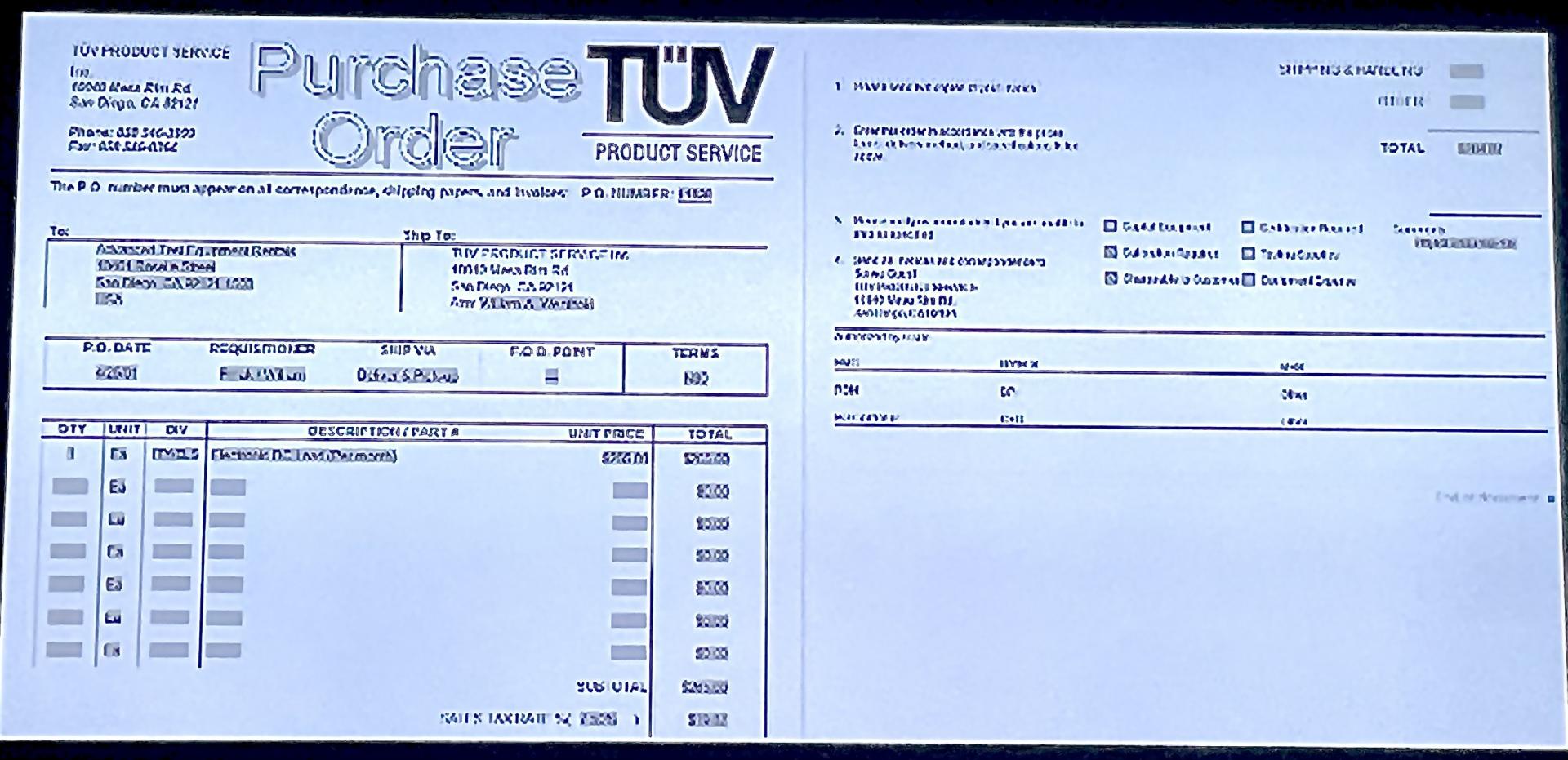

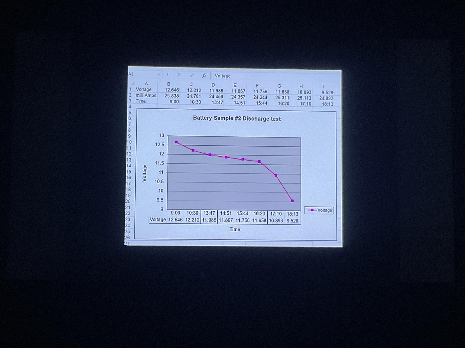

                          ‘TUV did not give a written report all the provided was these.
                          Click image for larger version  Name:	IMG_4589.jpeg Views:	0 Size:	145.7 KB ID:	513165
                          Click image for larger version  Name:	IMG_4590.jpeg Views:	0 Size:	186.3 KB ID:	513166
                          Click image for larger version  Name:	IMG_4591.jpeg Views:	0 Size:	172.1 KB ID:	513167
                          Click image for larger version  Name:	IMG_4592.jpeg Views:	0 Size:	220.5 KB ID:	513168
                          Click image for larger version  Name:	IMG_4593.jpeg Views:	0 Size:	199.7 KB ID:	513169
                          It is very hard to read the purchase order.
                          I watched all the videos, although I sped up through some parts of the last discharge / charge tests.
                          The testing that was carried out that day and what is found on the disc # 42 (four disc series) is as follows.
                          1) Test 1 charge 3 batteries from 1, the test ran for a little over 3 hours, until the primary was depleted and the 3 battery secondary bank was charged to under 13 volts. I posted the screen shots of the test and showed the test just starting, then a half hour in and then an hour in you can see the rate of charge to discharge in the images I posted earlier. The discharging of the secondary batteries prior to the test was not highly controlled so the amp hours removed prior to the test was estimated. And the primary battery was not verified for actual capacity and or state of charge prior to the testing either and may or may not have been fully charged from the factory.
                          2) Test 2 swapped the batteries, moved the primary to the backend and put one out of the three from the backend to the front and removed the other two out of the circuit and off to the side. The depleted primary battery (discharged by the machine at 100mA at the beginning of the test run to 40mA as the machine slowed down in rpm as voltage dropped to 8 volts) and the lone secondary which was charged under 13 volts before the swap.
                          3) Test 3 they swapped the same batteries back and forth until the machine stopped rotating, as was done in step 2. They did this until both batteries would not longer run the machine as both batteries were depleted.
                          4) Frank took the other two secondary charged batteries back with him and discharged by Frank at the TUV test facility. Those are the discharge tests in the images I posted above.
                          5) The same machine was used throughout the 4 disc series #42 tests, the one as seen in the video and screen shots, no other machine was shown in operation.
                          So all in all very disappointing as one assumed prior to ordering these videos I also assumed I would see 1:12 charging too. However as I stated earlier and as you can see in John’s photo album there were at least two days of testing as John wore different clothing. The footage of the second day was not part of disc 42 series, it was purposely left out for reasons unknown. Maybe to protect John’s discovery of how to produce 1:12? I do not know it is all speculation now.

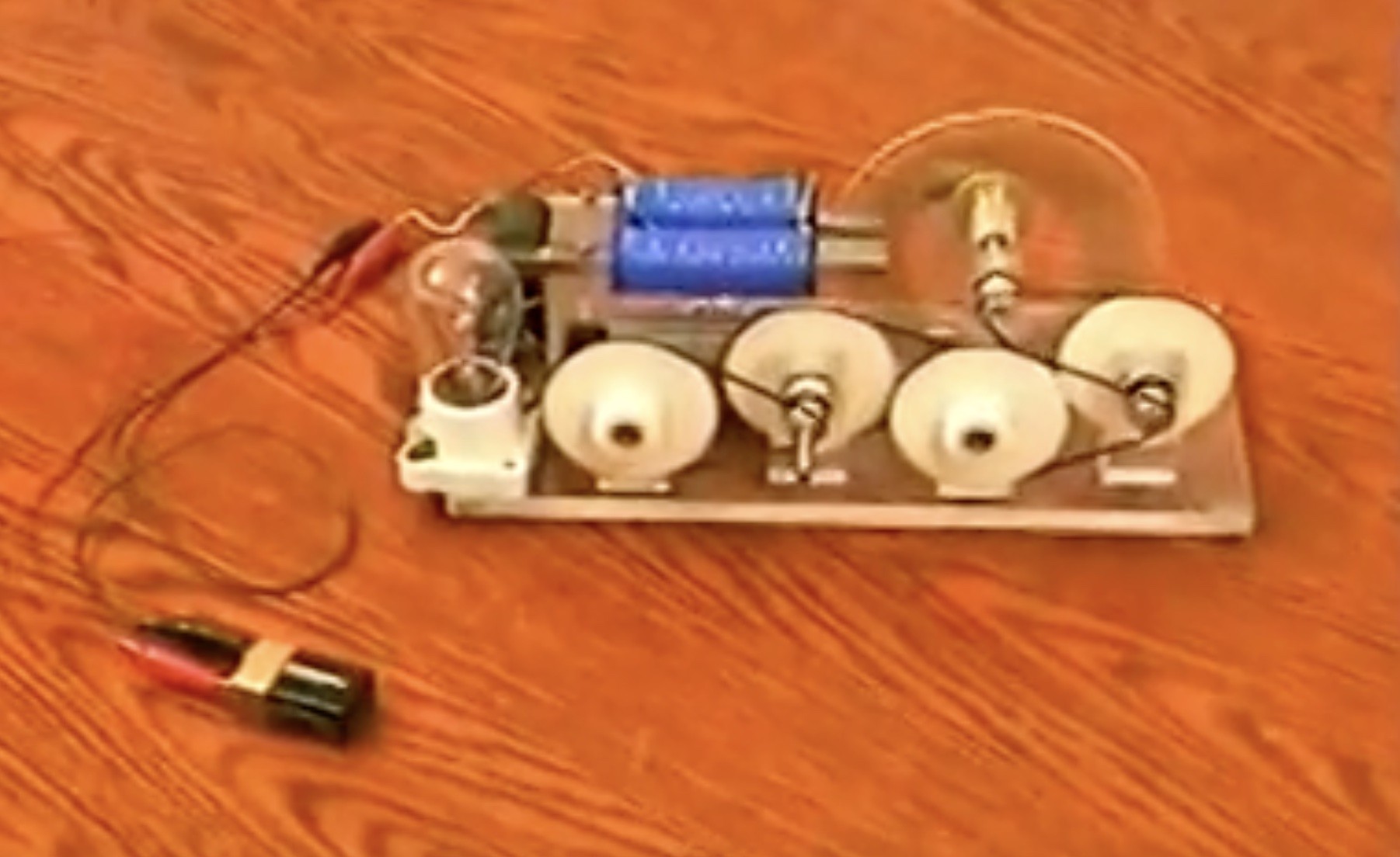

                              When you listen to Jay speak he mentions a 25 gallon drum where John cut off the bottom and installed a shaft and bearings, John made a large cheap rotor, the size of those drums are roughly 20 inches x 3 feet, a machine this size needs large magnets large coils large gauge wire with many turns, a machine of this size could easily charge 1:12 or even run for 6 months as stated by Jay.
                              John did say if you build it big you might see something. To me that is the key build them big, large magnets produce large fields, large coils produce large flyback and large amounts of torque. Frank also mentions he wanted to test the big machine as he spread his arms wide. What was the big machine? Was it the drum motor? Could be or it could be another more refined large motor?

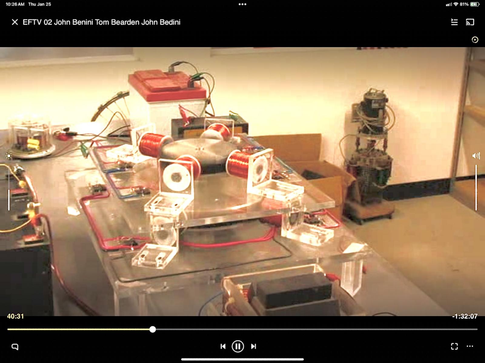

                                Here is a large motor generator hidden in plain sight… From Energy From The Vacuum Part 2.
