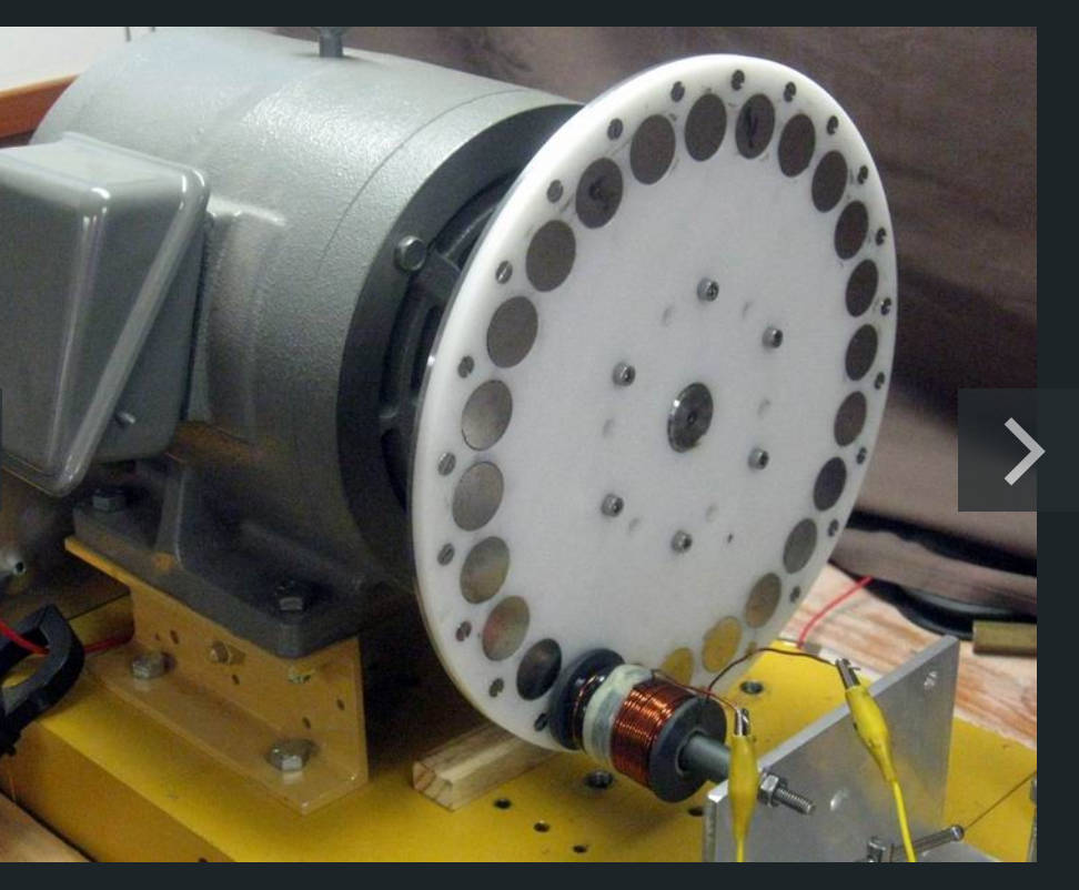

      Notice the precision popsicle stick shims.
      Think his core is dead nuts to +/- .001"?

        Here is what needs to be understood about this giant motor using a plastic rotor with small weak magnets and a coil the size of a spool of thread. The motor will consume 65% of it's FLA with no rotor. With the rotor that is so small the amps will not change. With a coil and rotor the 65% mark would still not be reached. A motor like this is a poor choice for accurate testing UNLESS a VFD is used to dial past this problem. It is possible. A motor like the one in the picture might have a FLA (full load amps) of 10 amps and so 65% would be 6.5amps regardless.
        What we need is a small record player motor that teeters on the edge of barely turning the rotor BEFORE cogging coils are added one after another. Then you can see slight increases where on a motor this large you might need a 30" rotor with 10-20 one pound magnets to reach this limit. 6.5a X 120v = 780 watts. I run a rotor this size on 10 watts.
        And that coil holder bolt will giggle like a Palm tree.

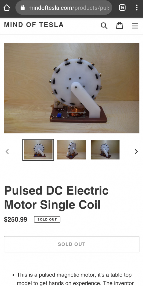

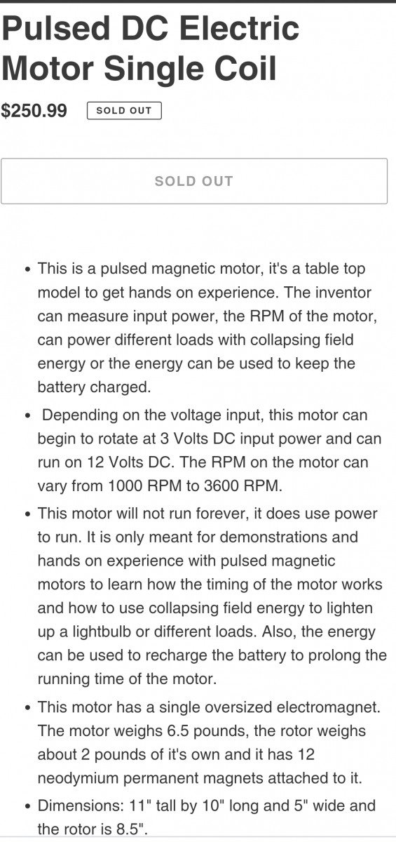

                      7th graders pulse motor, 4-5 watts input to turn rotor 4000 rpm for large 8" disk and many heavy magnets. Now add regenx coils
                      interesting.

                      $250 is how much 7th grade lunch money? Pretty smooth running. No core in the main coil. Looks like it tries to cog on the sense coil core, although it appears to be brass bolt. Maybe it settles with magnet near hardware for bracket.

                        Yes we were all told that core material plays a major roll in cogging as well as energy harvesting. It is not my fault that inventor continue to use soft steel bolts or other expecting world shattering results. All they get is wasted heat. Ferrite when used is often a little better than solid iron slugs. Looks like a 3D print job at school science class.
