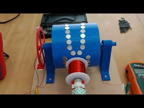

    ... Next Sat Greyland and the guys will shoot a video of the machine running unloaded with all 12 coils in place and show the amp draw. ...
    Hi Turion,
    How did the test go? Got a link to the video?
    • They didn't do the test. They worked on building the coil winder instead. And on some parts for me that they will bring me this weekend for my generator. My cores arrive this Thursday. Ten of them.

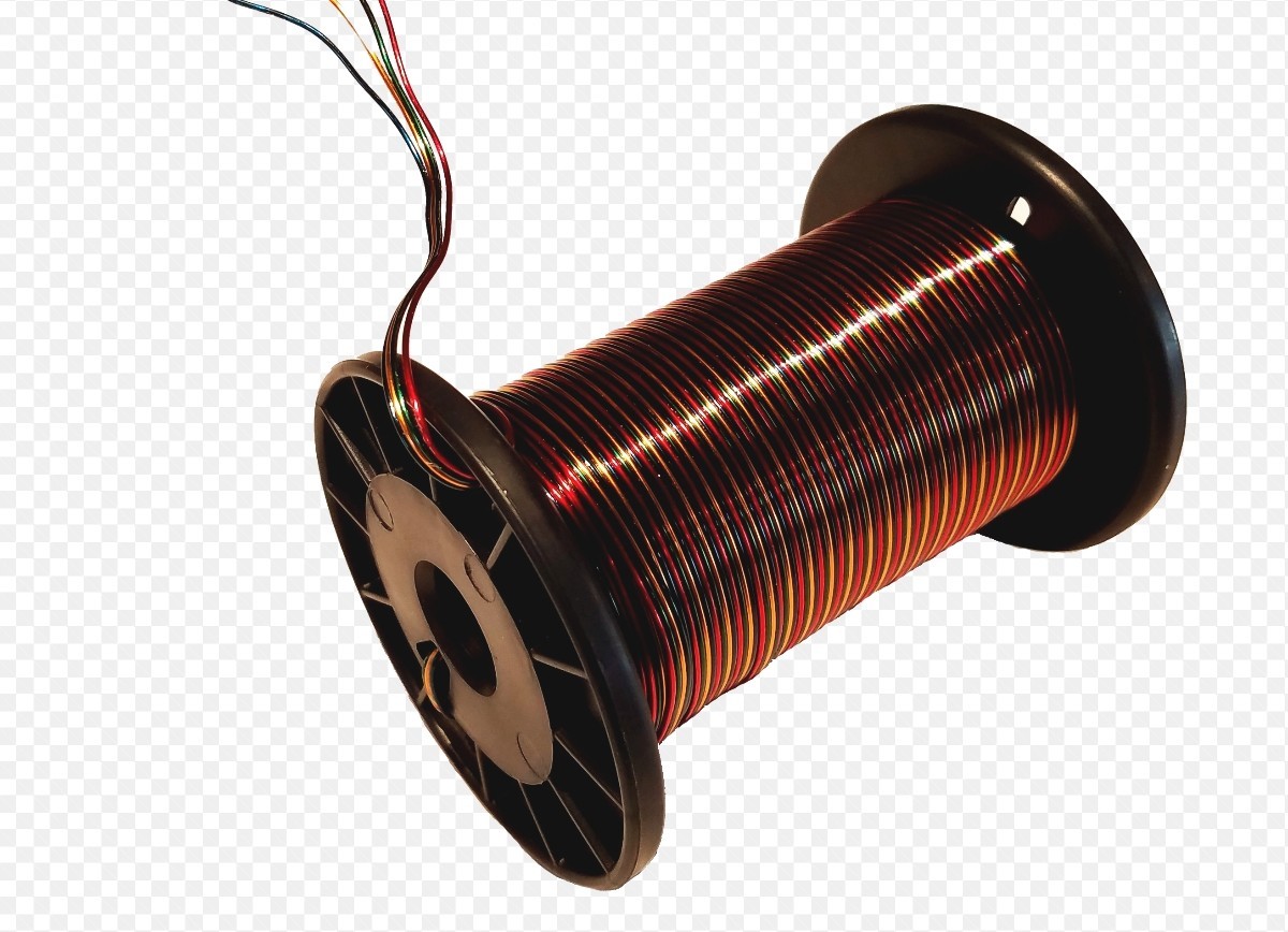

                              • The means to accuracy with mulifilar winding. Click image for larger version
