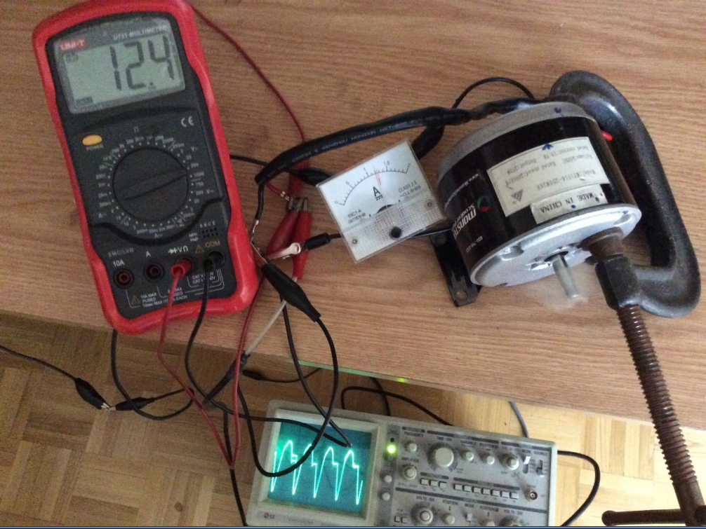

                            • Dave and Matt,
                              I'm looking over all of desa's posts and glad you brought these to our attention as he has done a good job on documenting and measurements.
                              I noticed his scope shot of Matt's Pulse motor are very different then my scope shots.
                              Unfortunately, desa did not mention where his scope probe is connected. Looking at the scope wave form it looks like the motors current wave form which may mean his scope probe is across the amp meter but I can't tell.
                              The reason I'm bringing it up is my current wave forms looks different then the one from his motor (see below).
                              Was there any modifications to the brushes?
                              I'm trying to make sure my Matt pulse motor is comparable to those who reported success.
                              Do you know if we can still get in touch with desa?
                              Your help would be appreciated and helpful
                              Luc
                              desa's scope shot
                              gotoluc scope shot
                              • Luc,
                                A quick comment about the difference in signals. It appears to me that both your's and desa's are the same except one of them is inverted from the other. Do you see something else?
                                Carroll
