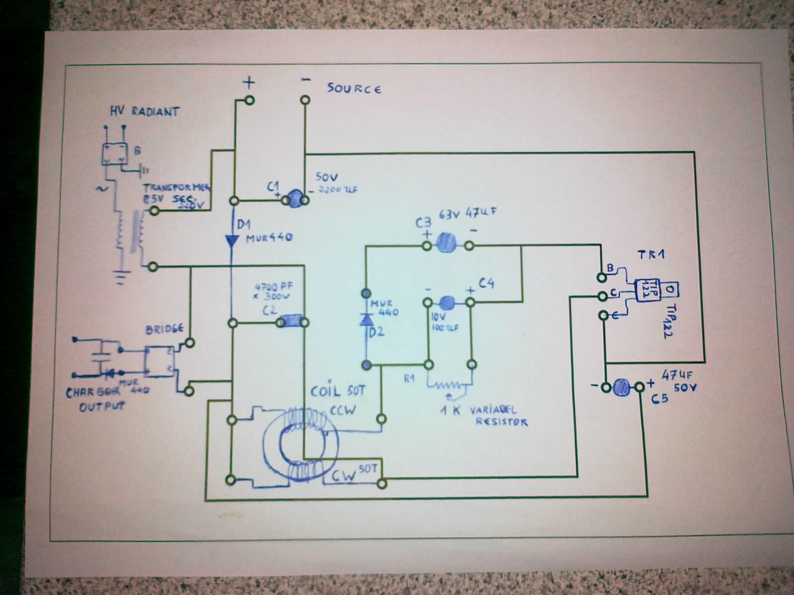

        I don't know personally Nelson but I admire his work; I think he's an excellent guide, but probably its corporate agreement prohibits him from being totally free.
        The care and precision of his videos speak for him.
        I replicated her mini radiant exciter circuit, using a different transistor.
        The circuit has 2 out: output at low voltage for charging batteries and an output that he calls HV radiant.
        The latter I think could be used to charge the capacitors,
        discharged continuously in a transformer from which to obtain energy.
        But this i s my speculation.
        Attached the original Nelson circuit and my semplification
        • #49
          Very smart oscillator,
          but I still not getting 0mA on the input side.
          Transformer T2 is very important for better results.
