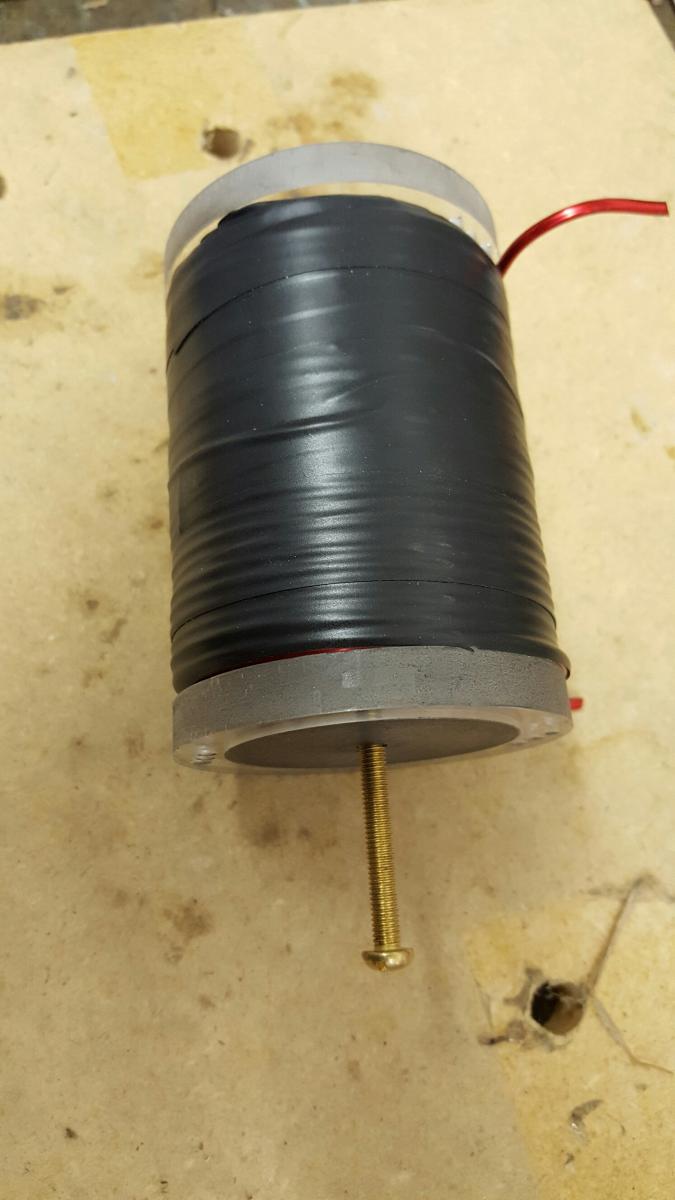

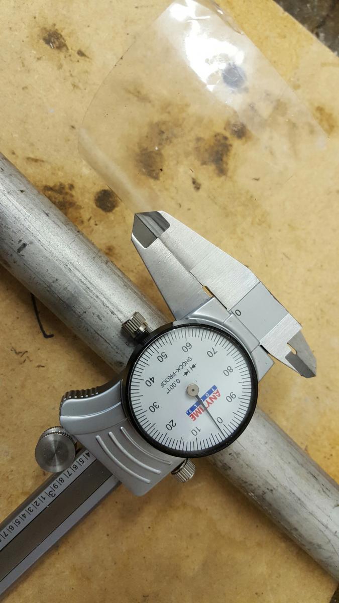

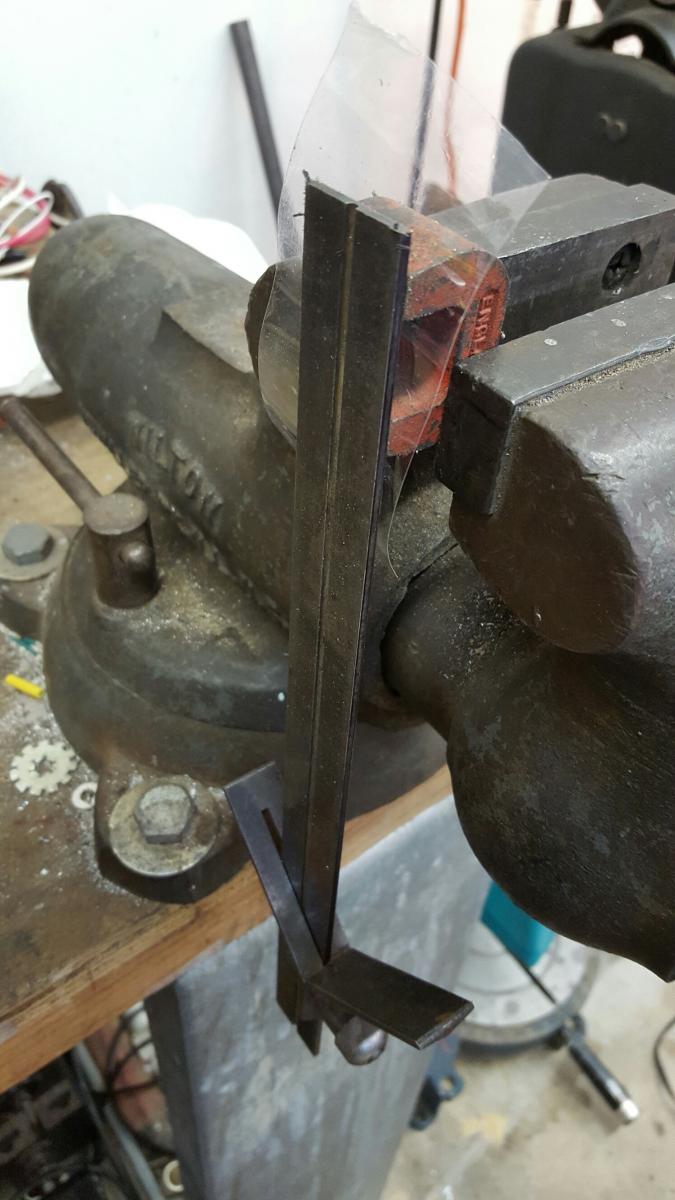

          • Plastic?
            The rings are Acrylic 025" they are a tight press fit on the 2" iron round bar.
            The iron bar sticks out on each end a very little 0.013" so that they will meat
            each other. The winding's are 3.214" wide.
            The middle core has two #10 by 32 brass screws, heads cut off for joining the three cores to each other. I never thought of gluing the ends together...brilliant idea I think I can still do this...will make a mess, but as I'm a mess...who gives a crap!
            Thanks for all the support!
            Shadow

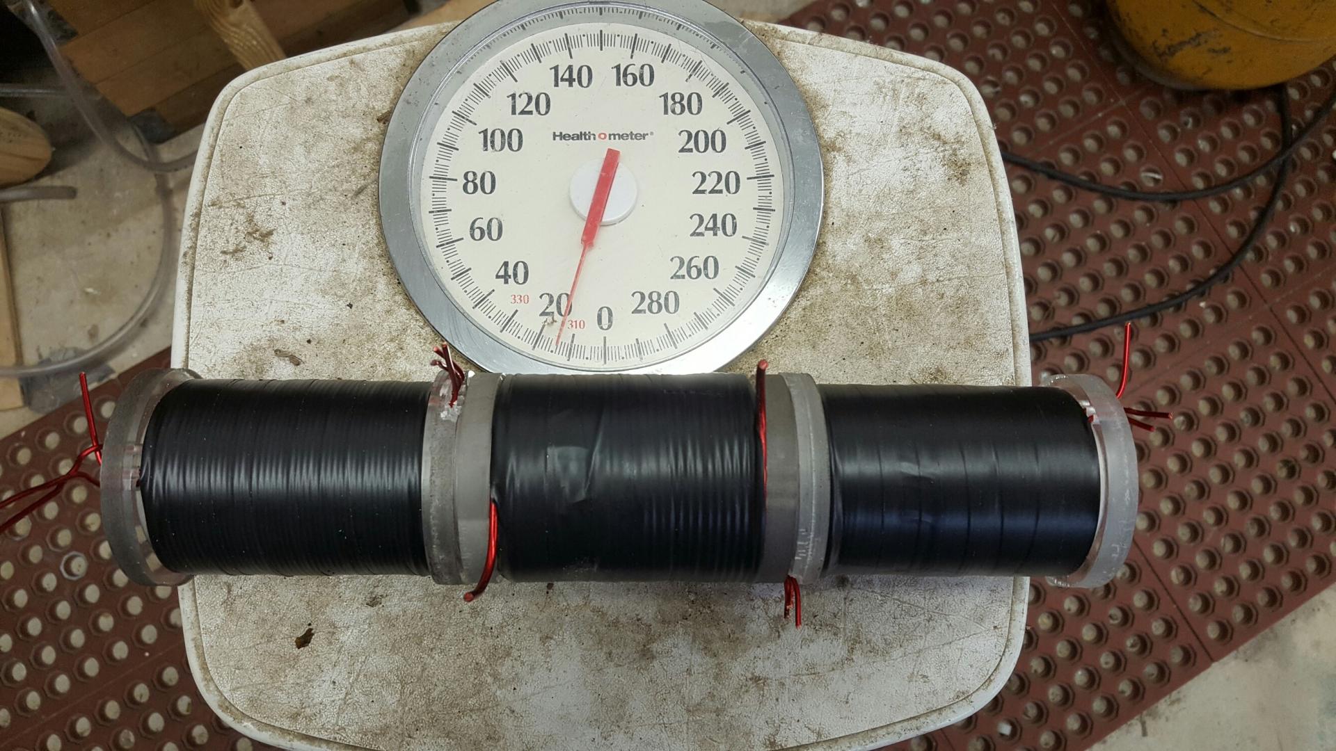

                        • One unit
                          Below is one unit brass screwed together. Total weight
                          is 14.5 lbs.

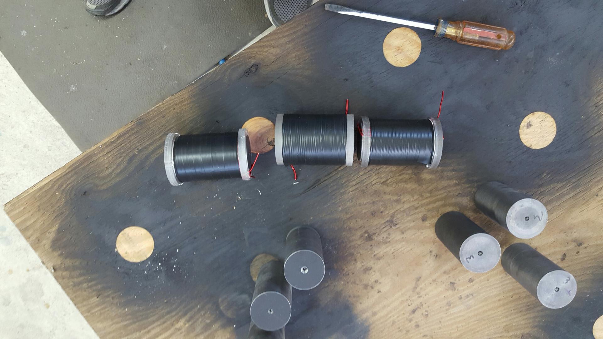

                              • Two sets
                                I have two complete sets done so i will begin inter connections. i have 10 awg red wire used for part G taps left over so i will use that for all inter connections.
                                i will post pic of semi finished sets before i attach 10 awg and outer tape wrap plus working on mounting base.
