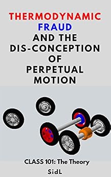

                  Originally posted by SidL
                  Hello Bistander, thanks for your input.
                  Indeed a very pertinent question. The answer is simple, money. Building stuff is not free of charge, and if I could, I would not be talking, I'd be doing.
                  Yet, a-step-at-a-time hurts no one. There is still service I feel I can render, which is to the minds of those with resources to build stuff. If you look at the book cover, the image there represents one of several ways in which an electric car can generate its own electricity, and I came up with more ways after I finished the book. My CAD skills only go so far to illustrate, but think about it, can one not mount a generator into the wheel system of an electric vehicle to charge the batteries when in motion? Is that a technical challenge, or is that a mental one?
                  And thank you SidL for your reply.
                  Battery powered electric vehicles already have a generator connected to the wheels which is used to charge the battery when the car is in motion. This either slows the car or prevents gain in speed going downhill. It is called regenerative braking. The energy put into the battery during regeneration comes from the kinetic energy gained from the reduction of speed during braking or the potential energy associated with change in elevation (gravitational). Technically this works very well.
                    No, that's not what I meant and I'm aware of regenerative breaking.
                    Take a look at the attached photo. A second pair of wheels has been added to which a generator is mounted, using the relationship between the rotating wheel and stationary hub--the red and blue portions. While the electric car does its thing, those 2 generators generate electricity.
                    What do you think?
                    Say at a constant speed on level terrain, the generators will require more energy input than they could provide to charge the battery so vehicle range is reduced.
                      I don't follow. With a rotating wheel acting as a rotor around a stationary stator hub, what more energy is required? The system is passive and merely leeches established motion. Let me give an analogy, its like mounting a small electric windmill on the top of the car to generate electricity every time the car is in motion. That is what the picture in the diagram describes. The only difference is that the "wind" is the rotating tyres. There are even simpler ways.
                      "leeches established motion" meaning sucks the life blood from that motion. And energy is the life blood of that motion. So the generator sucks energy from the vehicle motion requiring the motor to put even more energy into the vehicle motion to maintain speed and cover conversion losses.
                        Say it takes 10 kW from the motor to push the EV at 50mph. The motor takes 11kW from the battery to make the 10kW required mechanical power. So your generator needs 11kW electrical output just to keep the motor running (more if you want to charge the battery also). For the generator to output 11kW electrical, it requires 12kW mechanical input. Where does this 12kW mechanical power come from? The only place on the EV is the motor (unless it's a hybrid). Now the motor must output 22kW (12 to feed the generator and 10 to move the car). To output 22kW mechanical power, the motor needs 24kW from the battery and generator combination. The generator electrical output is 11kW.
                        So with the generator, to maintain 50mph, you use 13kW from the battery (24-11). That is 2kW more than the 11kW needed from the battery without the generator. 18% increase in power to go the same speed using the generator means a much shorter distance per battery charge.
                          The mechanical power will come from the generator attached to the tyres.
                          I am not sure you understand me, so let me put it another way.
                          *Battery energises motor.
                          *Motor turns the wheels (moves the car)
                          *Generators attached to other wheel systems in the already moving car generates electricity as the car moves. It is analogous to the windmill generators, where the wind is the moving car or rotating tyres.
                          *Electricity used to recharge the battery.
                          *Battery energises motor--the cycle repeats, i.e. "perpetual motion."
                          It really is that simple.
                          How difficult is it for the rotating tyres to have magnets mounted to them to induce current in the winding attached to a stationary hub?
                          You say "The mechanical power will come from the generator attached to the tyres." You have to put mechanical power into the generator to get electrical power out of the generator. That's how generators work. And you always have to put more power in than you get out. That's loss.
                          • #14
                            Is the tyre not already turning? Is that not mechanical power otherwise wasting away? We have been wasting it all away for decades. That's all I am saying.
                            Turning? No. That's not mechanical power. Mechanical power (rotational) is the product of angular velocity (turning, as you say) and torque. Torque on the generator is a force opposing rotation. The larger the electrical load, or electrical power output from the generator, the more torque will develop opposing rotation which means more power needed to move the car.
                            • #15
                              SidL,
                              What Bistander is telling you is absolutely correct. It takes real mechanical energy to turn a generator. If you put an electrical load on a generator it takes mechanical power to turn the generator. You say you are familiar with regenerative braking, but it appears you are not. Regenerative braking works because we use the motor as a generator to recharge the battery. That mechanical load of recharging the batteries is what slows the car down during regenerative braking.
                              If you can find someone in your area that has a bicycle with the little generator that mounts on the wheel you can try a simple experiment. Ride the bicycle on smooth level ground and notice how much energy it is taking for you to pedal the bicycle. Now turn on the headlight that is connected to the generator. You will feel the bicycle slow down and you will be able to tell you are having to pedal harder because you are now having to add mechanical power to the generator so that it can light the headlight.
