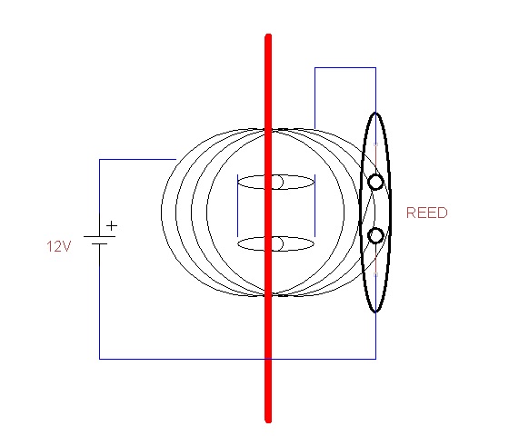

                    Yes... very contagious, love working on these smaller projects. Allen is this schematic how we are connecting everything up, or is there a need for the reed relay?
Name:	Reed Motor Schematic.jpg

                            Schematic.
                            @Minoly,
                            The schematic looks pretty good. I'm sorry I can't supply you with the actual core dimension of the thread spool and the Ohmic resistance of the windings. The original coil's out of reach, in a storage locker back in Northern California.
