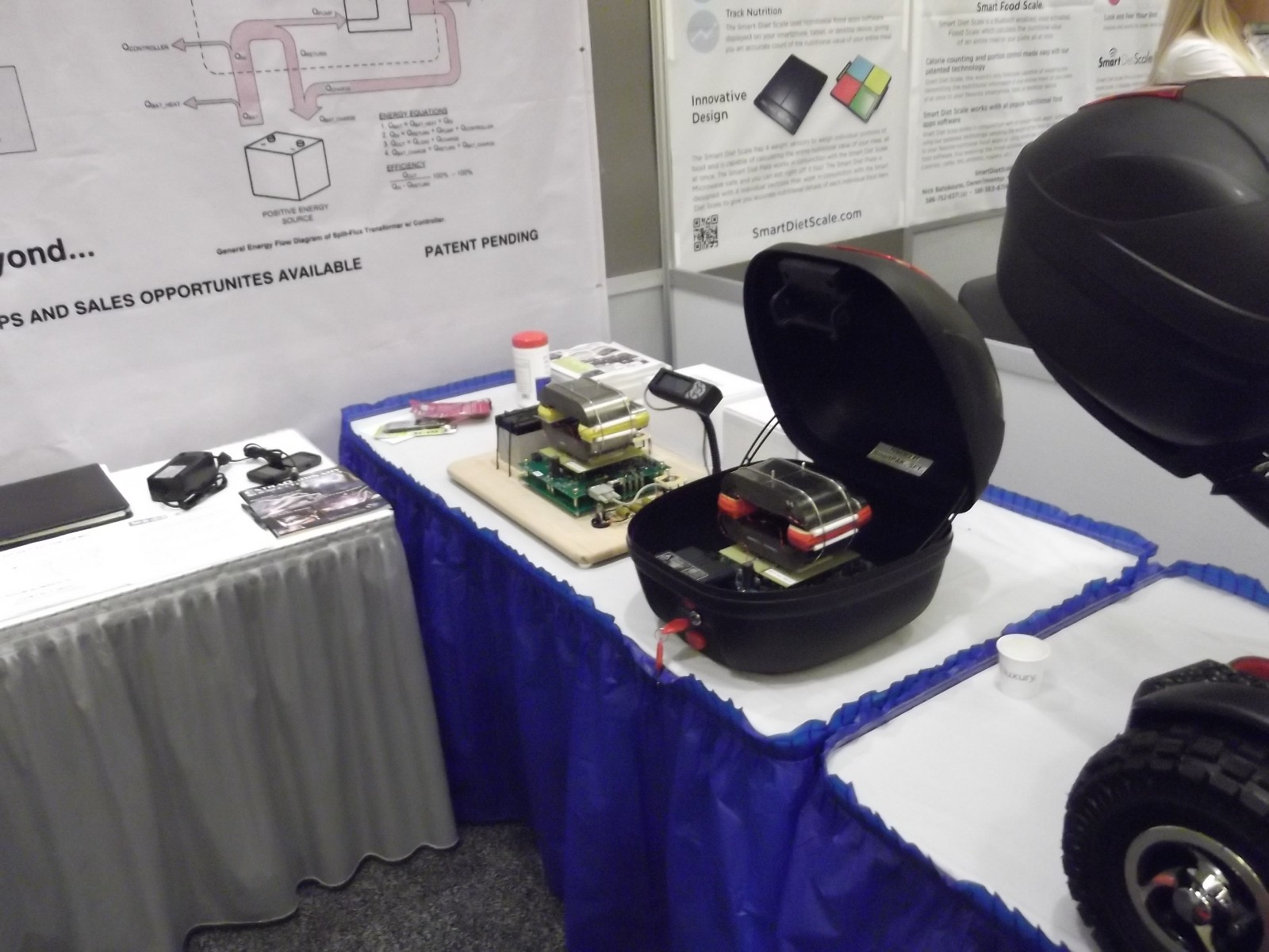

            I have seen a lot of setups from tesla coils to Don S. fail or Bitt or SFBT or bucking coils, all empty handed over a 50 year period.
            Most people get mutual induction and freak out thinking they got it.
            However the SPLIT PHASE BI-TOROID does work when using a sine wave signal. See Bill Alek who vanished suddenly after he offered a version of the THANE HEINS Bitt on a scooter that recharges itself.

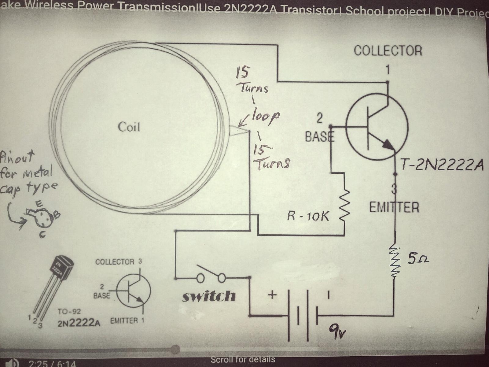

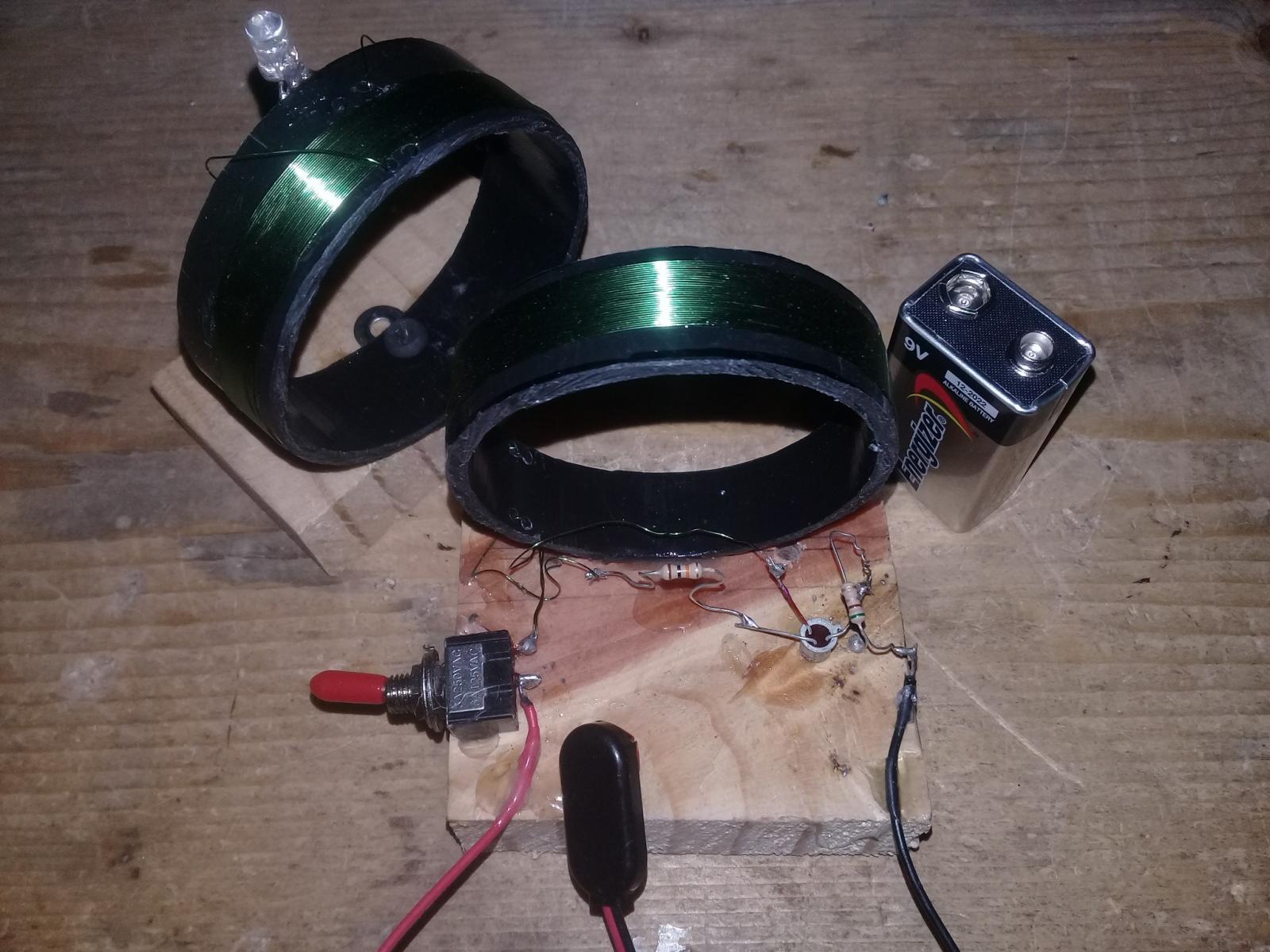

              BroMikey, I don't think that I will be vanishing too soon as I have no intention to try to make money or go into business making anything that will upset the applecart. I'm retired and I want to put together stuff that works for me and mine. Going up against big business to sell a scooter mod is not my idea of retirement. I prefer eating, sleeping, and sex without having to look over my shoulder to see if men in black are intruding. It spoils the mood.
              Here's another short video: https://www.youtube.com/watch?v=69CT...ature=youtu.be
              I added a 5 ohm resistor to the circuit because the battery dropped off too quickly. The amp draw must have been excessive. After adding the resistor, the LED was still extremely bright, maybe too bright. I may add more resistance (I tried 10 ohms and it wouldn't light at all).
              I can't wait to show this around. I think young and old alike will enjoy it.
              Take care,
              Bob

              • Wireless Energy

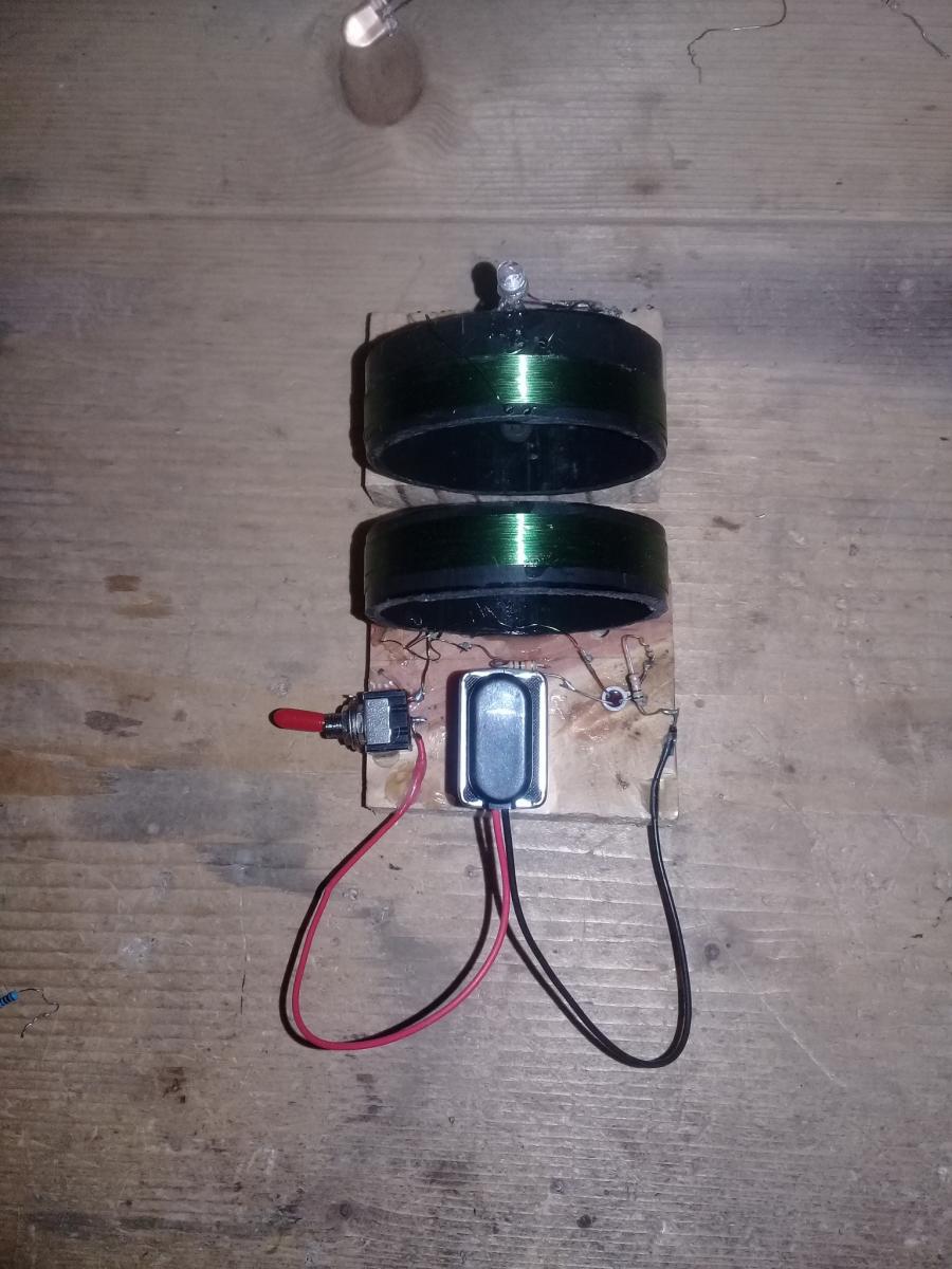

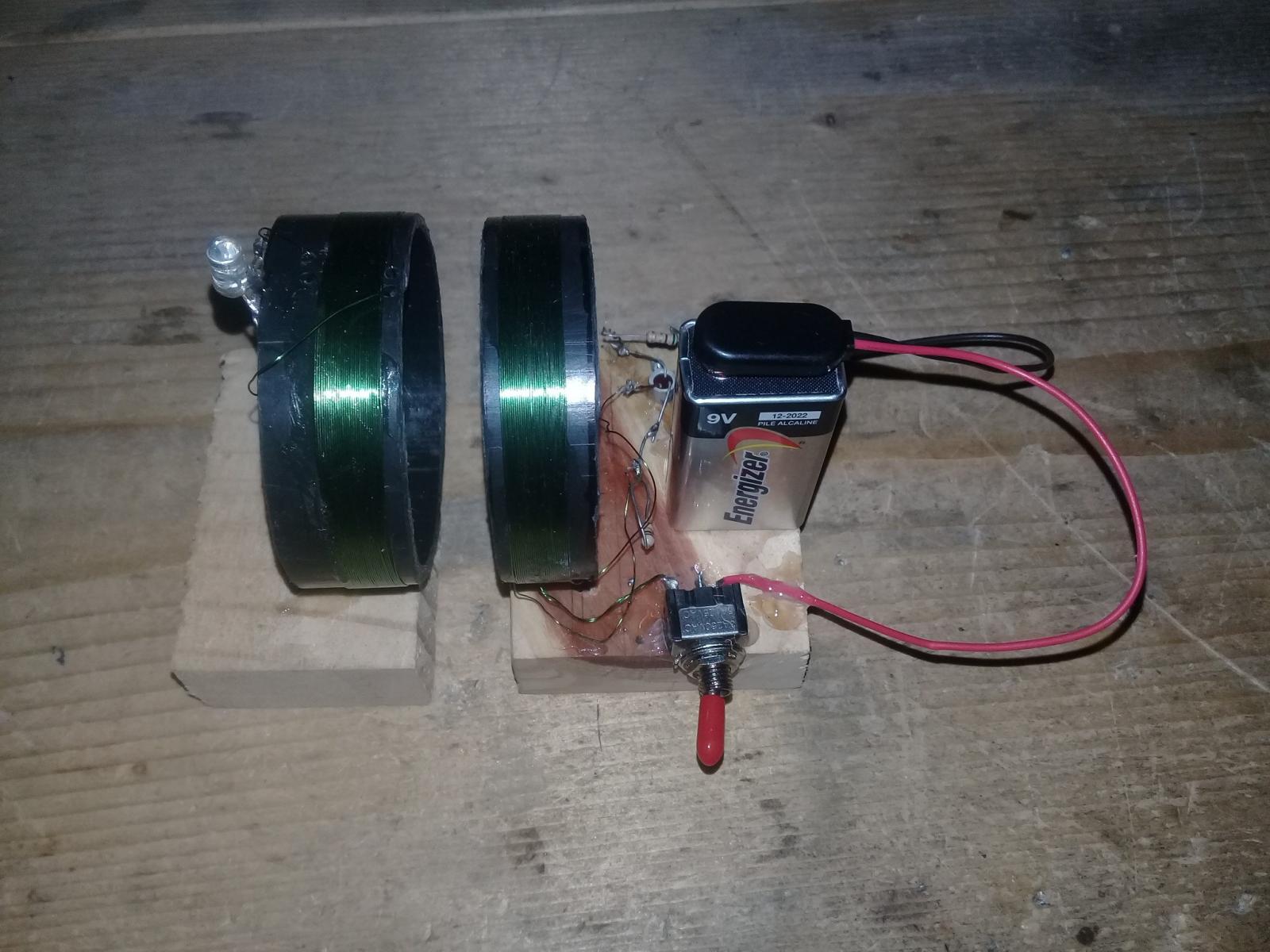

                I should have included a little bit more info in the last post. In winding the coils, for the transmitting coil you wind 15 turns, then make a loop (which is only there as a center tap that goes to the Positive battery post), then continue another 15 turns in the same direction as the other 15. This is a pretty clever way to trigger the transistor.
                The secondary coil with the LED is just a straight 30 turns with a 3mm LED across it. This is a very simple project...if you get lost in it, you might consider taking up knitting (just kidding, if you have a question, I'll gladly answer).
                Bob
