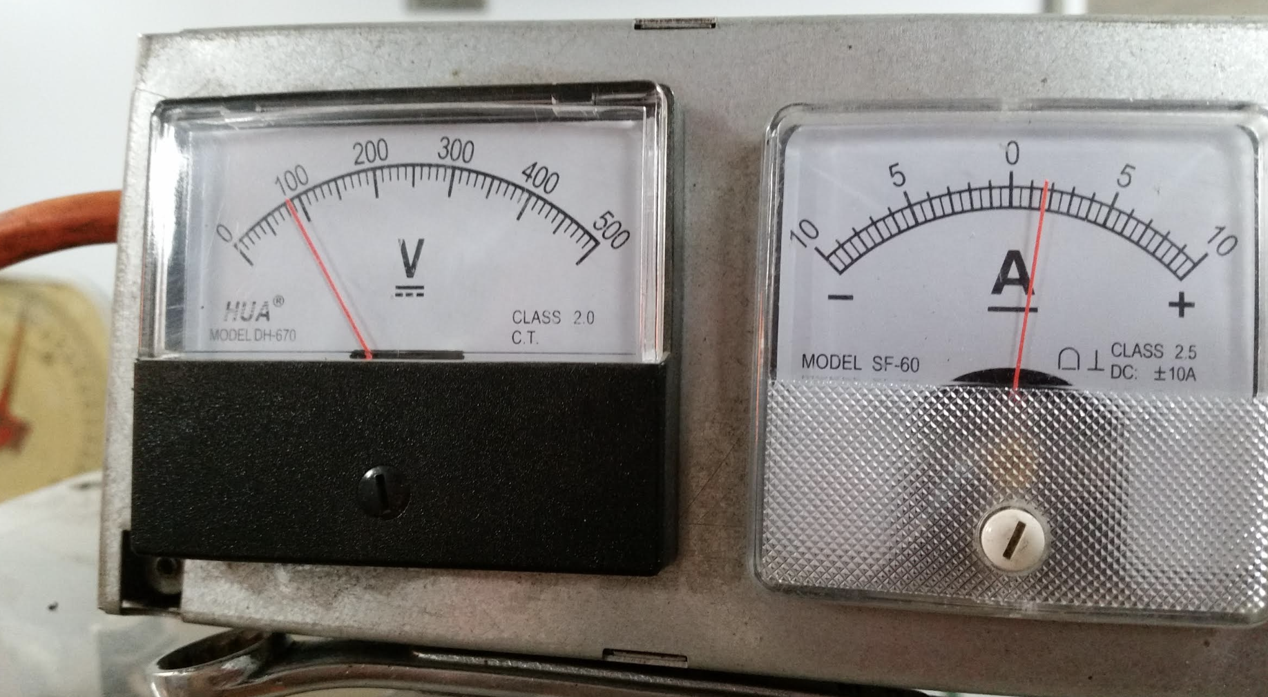

                  • Its a relief to have enough wire for 12 cores. Looks like enough left to do it again ! Still got 8 to insulate yet. Almost 85 ft. of wire each one. 250 pcs each is 3000 pcs I cut (the easy part with a machine and counter) and straightened by hand (the hard part). Interesting note; 2 of the 4 cores that are done were in the machine for the 4 hr. test. They are wrapped tight with 1/4 in. PVC tape that does not stretch. PVC melts @150 deg. yet no tape burnt back. They are just as you see and probably couldn`t pick the 2 out. That tells me all the heat is generated on the very end and eventually warms everything else up. I think we are safe with these cores. Remember I had steel wire cores melt epoxy thru out the whole core. We are safe.
                    My drive motor is an older 1HP Reliance ( bought out by Baldor) 90vdc-56C @ 2100rpm 8amp max. At about 90volts by my panel meter I can easily get 2400-2500RPMs. If I goose it up to 100vdc I can get 31-3200rpm and it still doesn't seem to get hot. Max amps it has pulled constant is 4 + with all 12 ferrite cores. I expect with 12 of these wire cores it may be much more and uncertain if this motor will still do it direct drive. I can always go back to belt an gear it down. In the back of my mind this is my failsafe since I`m so impressed with the output at very low rpms. I still have bright bulbs at 12-1300 rpms. I know we have the Lentz factor to deal with and low rpm may not be possible. Just got the Garlite, starting to work on the (2) disks and then just let it run while I do shop work.
                    Got (2) coils switched over to (6) wire setup and run a little. I would have to say best test so far. At 2400+ rpms with 2 X 60watt bulbs it holds 90+ volts and lights the bulbs to full brightness. Add a 1uf cap and voltage holds at 110-115 and with a 60watt bulb plugged in to a power strip right beside the (2) powered by the machine there is no difference at all. Thats target voltage for me but I`m afraid that still might be a little low so I am going to wire up (2) for (4) wire setup and try it.
                    (Lenz may be a problem at this low an RPM, so we will see.)

                      Thanks for update.
                      Are meters on input to Reliance motor?
                      What is meant by (6) wire vs (4) wire setup?
                      What are Garlite/(2) disks?
                      • Meters are on input to prime mover motor for generator.
                        6 wire and 4 wire are the coils. His are wound with 12 strands, so he is putting two strands in series on some coils (to end up with six wires) and three strands in series on other coils (to end up with 4 wires) to see the effect on Lenz as well as output. With different configuration you have to operate at a different rpm to neutralize lenz, which affects the coil output. So testing determines the best combination. Because you MUST either change the rpm or change the coil configuration to nullify lenz, you must experiment to see what changes give you the most production as a generator coil. I have chosen to rewind all my coils with just three strands and adjust my rpm accordingly. He has coils wound with 12 strands and is not interested in redoing all his coils at this time.
                        Garlite disks are blocking the end of the "tube" the coil slides down so that it cannot hit the rotor. Needed a something not affected by the heat generated by the core end. Was testing diffewrent thicknesses and the effect on output.
