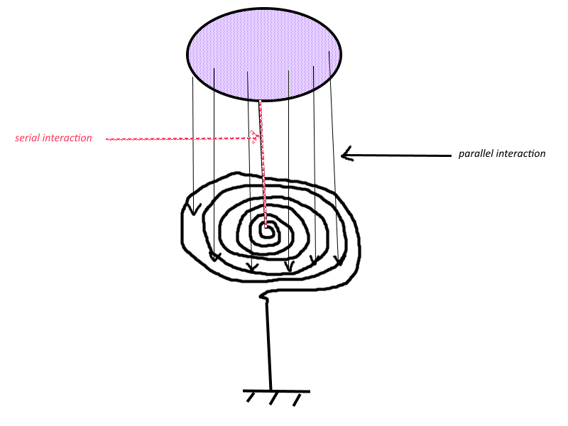

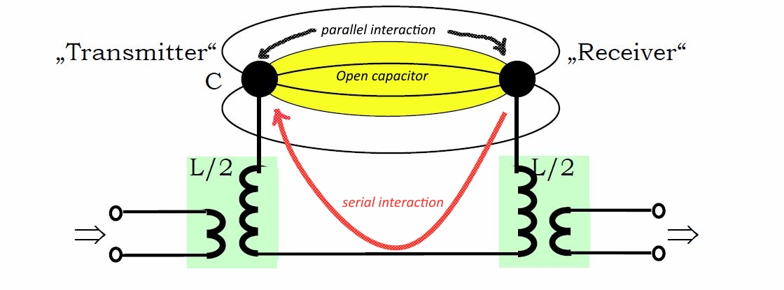

Just an idea to share about Tesla wireless power transmission and the strange relation between inductance and capacitance which indicate the presence of parallel /serial interaction both at the same time :
from the receiver sphere into the transmitter sphere both the capacitance and the inductance are related in serial while the two spheres are connected in parallel in the open air !

in order to benefit from electrostatic induction we have to understand the parallel/serial interaction mechanism!

It would be advisable not to pollute your mind with Konstantin Meyl's rubbish. What he means to say is:Originally posted by med.3012 View PostJust an idea to share about Tesla wireless power transmission and the strange relation between inductance and capacitance which indicate the presence of parallel /serial interaction both at the same time :

if the spheres are removed the system would fail ! if earth connections is removed the same thing happen! the idea consist of understanding parallel/serial interaction both at the same time which involve the presence of special mechanism, Dr Konstantin Meyl's didn't mention serial/parallel mechanism, it's a very important idea at least the way i see things ....

very nice photos ! thanks for sharing your experiments with us, i think my idea is still unclear, in Tesla patent number 787.412 named ART OF TRANSMITTING ELECTRICAL ENERGY THROUGH THE NATURAL MEDIUMS , he used the word art! this why still some people see this men as genius inventor but not as scientist, he simply was an artist...
in your experiments there is no spheres but i still see the parallel interaction because you can't avoid self capacitance.
in Tesla wireless transmitter he used this kind of interaction!
parallel interaction is the relation between the sphere and the large diameter secondary coil, the serial connection is show in the above drawing between the coil and the sphere , Tesla simply used the capacitance portion of the secondary coil with the sphere in order to secure the parallel/serial interaction which is ( in my point of view) the secret key for power amplification !

I'm not sure that I'd agree with all that, but yes, the coil has self-capacitance in space. This is what I mean by the fact that the transmitter and receiver are both "isolated" systems in space (from each other). They are both independent, each has its own independent self-capacitance to space and one doesn't need the other in order to work by itself. (Meyl's experiments and claimed faster than light measurements all collapse = useless).Originally posted by med.3012 View Post@dR-Green
The terminal capacity adds to the coil capacity and the resulting frequency is based on the total capacitance of the coil + terminal.
The wave isn't confined to the conductor which is how apparent faster than light propagation velocities have been measured. So maybe your general idea is right in that respect, at least as far as what can be drawn in MS Paint.http://www.teslascientific.com/
