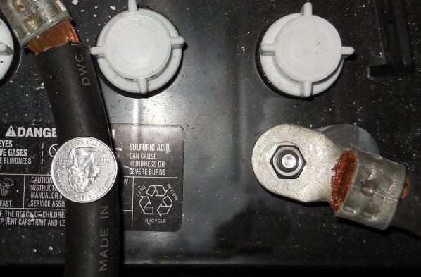

I just hate to lose any current by being stingy on wire gauge. My 0000 (4/0) gauge battery cable for my inverter (that's a U.S. Quarter on top of the cable for size reference and also note it's welding cable that uses a whole lot of very tiny gauge wires) I know we all do what we can with what $$ we have but if you can afford the heavy stuff and especially for the short piece of captor cable I'd like to see what difference some extra heavy welding cable might make :Last edited by ewizard; 04-15-2015, 02:55 AM.There is no important work, there are only a series of moments to demonstrate your mastery and impeccability. Quote from Almine
Thats the good stuff Wizzz..........Originally posted by ewizard View PostI just hate to lose any current by being stingy on wire gauge. My 0000 (4/0) gauge battery cable for my inverter (that's a U.S. Quarter on top of the cable for size reference and also note it's welding cable that uses a whole lot of very tiny gauge wires) I know we all do what we can with what $$ we have but if you can afford the heavy stuff and especially for the short piece of captor cable I'd like to see what difference some extra heavy welding cable might make :
Check me out on this side, enclosed for serious builders is a foto
