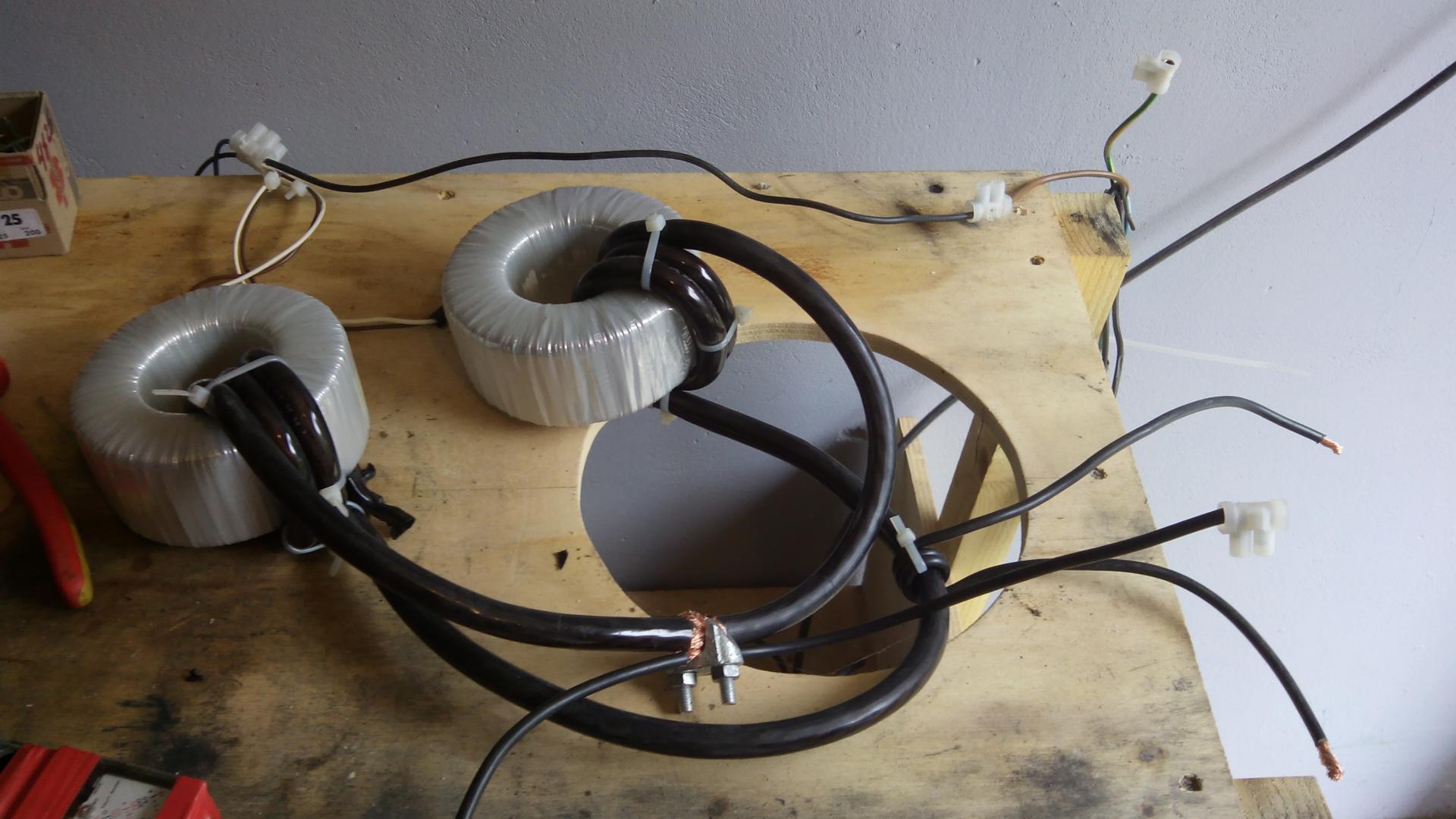

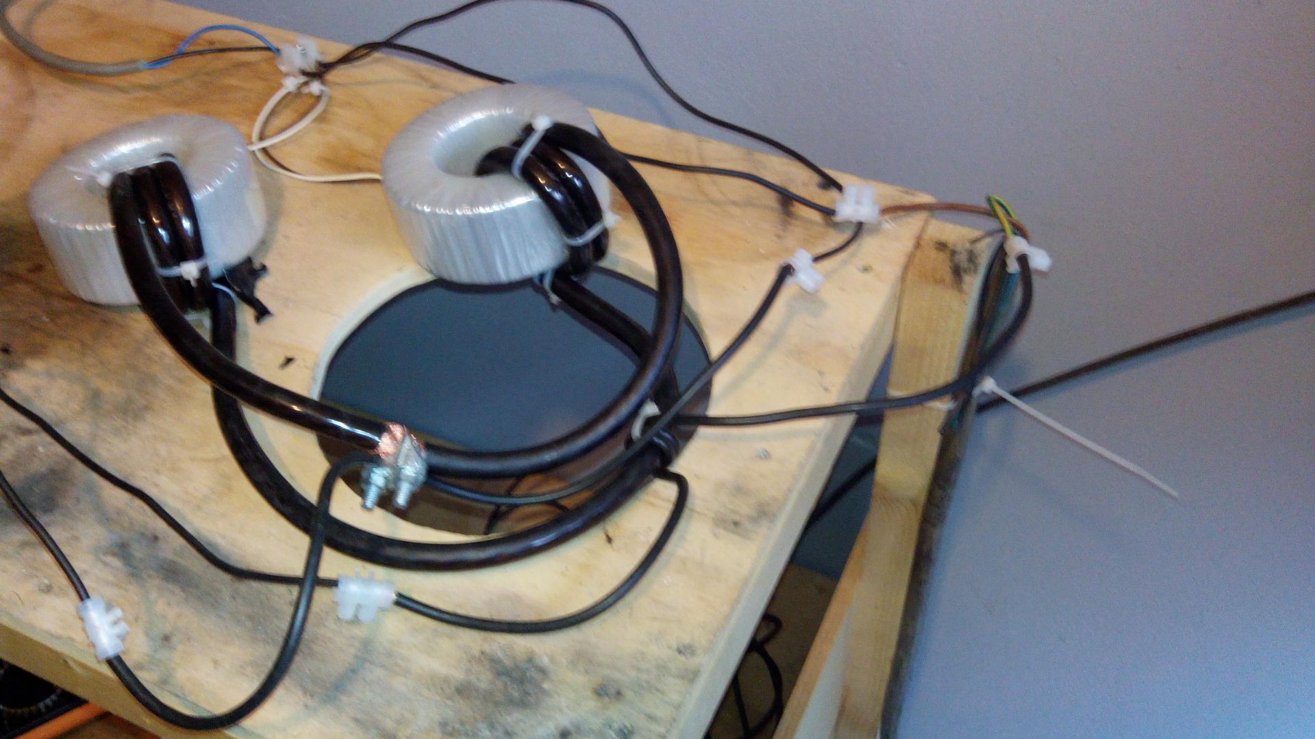

Hello djarno,
You have screwed up the secondary winding procedure and could burn up the wiring with a lot of amps.
why people can think they are going to SAVE a connection clamp and still get the winding procedure correct is beyond me!!!!
looking at the photo of your toroid setup - CUT the D--- top wire between the toroids so you can rewind the toroid on the LEFT side in the photo and make IT MATCH the toroid secondary winding as shown on the Right toroid!!!!!!!!!
TRYING TO TAKE A SHORTCUT ----ALWAYS leads to a screwup!
