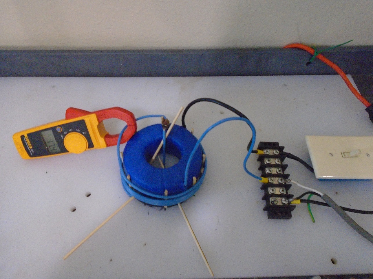

            Wantomake,
            Yes, I found out that its not nice to change ac to dc and then try to use it to power loads that are designed for AC use only. Invariably a person winds up
            rectifying the voltage in the wrong direction and ends up with a short which
            trips breakers or fries inverters. That's why I am using mains at present because the breaker will trip before I can say "oh ****" and move my arms
            and hands to make a fast disconnect.
            But I am also mindful that you are in a different position to make trials since your shop is far away from the house mains availability.
            I tried some diode use in the line output and ground input this AM ( making SURE of diode orientation ) and found it would lite bulbs up to 250 watt heat bulbs. But when I tried a floor the blade would barely move and the motor growled at me like a mad dog! had my hand on it's switch tho and saved the day.
            For now the only thing I try will be the captor and coils involved with it.
            I started with the # 1.0 ought loop making notes.
            Mine shows 74.9 amps as normal.
            When I use the DVMM meter with positive to ground return and the neg to
            the exposed split bolt connector it show a potential of 31.2-4 ac volts.
            Doing the same thing but instead touching the positive lead to line input it shows 10.49 ac volts.
            Doing the same but touching the positive lead to the mains positive input
            it shows zero.
            All of this tells me there is a voltage component in the loop but it is small
            and it SEEMS directional ( only an assumption for now ).
            When I disconnected the loop and just left the two ends exposed and measured for voltage my meter shows 0.2 volts . This seems more than I would expect. Transformer rules go like this: Input voltage/divided by primary coil turns/ equals the volts across each off the 660 turns.
            That is how much voltage will be impressed on each turn of the secondary .
            Since the secondary only has ONE turn through the center of the core
            it should go like this: 120 VAC/660 turns=0.181818181818.
            I guess that's not enough difference to quibble about so i'll settle for the 0.20
            reading.
            It still has to be validated that there is any voltage in the closed loop.
            The 1.0 ought is supposed to have the advantage of size versus heating.
            So next I'm going to do the "smoke and fire " test. It takes BOTH voltage
            and AMPERAGE involved in a circuit or coil to that is shorted to produce HEAT!
            I'll see if the voltage and amperage in the B&L loop has got the goods to make some heat or NOT. if it DOES then I'll move on to next things to check.
            Later J
            Clarence
            • No smoke no fire
              Later J
              Clarence[/QUOTE]
              Wantomake,
              No Smoke No Fire.
              What I did find out is that the Loop thing works like they have it set up.
              The only thing different with any loop set up will be the Amperage values
              it will handle and the corresponding amperage value of the toroid as it drives it.
              Everything varies according to the wire size you use in the shorted loop.
              If you used 4.0 ought cable then the amperage inside the shorted loop
              would be somewhere around a thousand Amps or so. All corresponds to what they said years back. Beginning to make the patent look more and more important.
              The little wire size and the clamp meter says it all. I used # 12 AWG.
              The milli Amp reading on the toroid driving this showed .04.
              Well, tomorrow I'll be back to further coil trials.
              Have some for me.
              Clarence

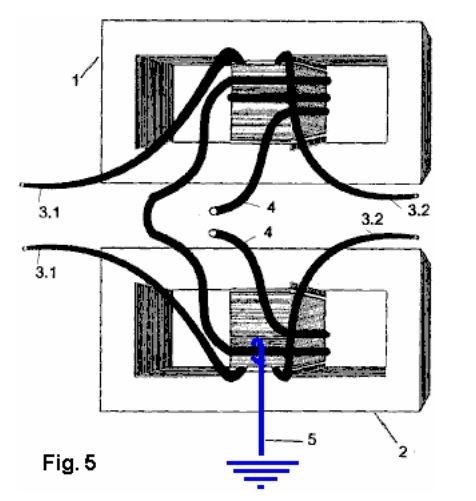

                          Wantomake,
                          I did manage to take the time to use the two Primary only Toroids that I had.
                          The results were finally what I was looking for.
                          It turns out that the depicted information in the photo shown in the thumbnail
                          is only for ILLUSTRATION PURPOSES ONLY.
                          The word LOOP does NOT refer to the SHORTED LOOP AT ALL! It simply means the CONTINUATION of the Item #4 wire from one transformer to another!
                          The OPEN ENDS of the #4 illustrated wire become the HOT and NEUTRAL
                          of the circuit to POWER LOADS!
                          THIS process eliminates a DIRECT WIRE CONNECTION TO POWER LOADS.
                          It makes the power supply to the loads AVAILABLE BY MAGNETIC FLUX through the transformers.
                          Using the TWO transformers gives the same voltage but DOUBLES THE CURRENT.
                          The number of turns on each transformer for the #4 illustrated loop
                          IS NOT TWO TURNS - as I said that was only for illustration purposes.
                          The ACTUAL number of turns DEPENDS on the number of turns in the Transformer PRIMARY!
                          I will add the necessary secondary winding and finish the rebuild in the next few days or so.
                          ALSO- After many trials with IT the focus of the trials the ole # 1.0 ought
                          SHORTED LOOP will NOT be in my setup anymore.
                          This I found out:#1- it WILL NOT induct voltage or amperage into anything.
                          #2- It is pure EYE CANDY - A White Elephant - A DoDo Bird.
                          #3- It serves NO purpose.
                          Talk more in the next few days to come.
                          Clarence

                              Wantomake,
                              The single primary toroid has 330 turns of say 22-24 AWG mag wire. However, I'm going to use the old standby #20 AWG to finish the secondary on my two .
                              I would suggest you use the 660 toroid and wind over it for a secondary
                              with 330 tourns of #20 mag wire also. Just do a reasonable back and forth
                              right hand wind wherever it looks god for you.
                              The transformers in series are supposed to be balanced with respect to having equal turns ratio, but just for a preliminary trial the lower voltage
                              output from the 660 unit may not matter all that much. The dual in series hookup will give double the amperage output anyway. (Hope so.)
                              You said I had good results - here are the facts so you will know. The continued circuit through the two winds gave a total voltage output from open end to other open end of 2.0 volts. When I disconnect the line wire to just one of the toroids the voltage dropped to 1 volt - hooked it back up so two were in series again -bingo - back to 2 volts output again! For the other test of the out put I connected it to the Ground return - Remained 2.0 volts.
                              Normally when I would touch a low voltage AC indication to the ground return
                              all voltage indication would disappear- not so with this setup.
                              All of this noted info told me that first of all the voltage output was real,
                              secondly it told me that the two winds were just for illustration purposes and that the secondaries had to match the primary winds for a balanced transformer output - namely 120 in with 120 out.
                              Also it told me that the input was DIRECT power from mains and that the output was from MAGNETIC FLUX - the separation I was looking for.
                              Hope all this explains whatI foundout and what you can expect for youself.
                              Later J,
                              Clarence
