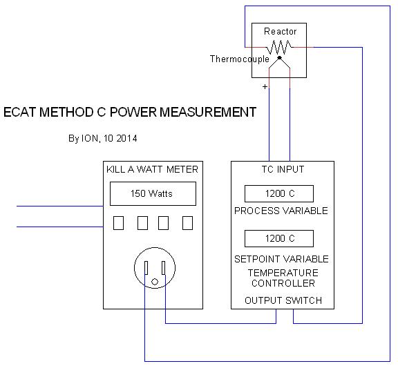

    Here is a simpler method for those wanting to get started in ECAT type testing. A single heater is used, but a curve of input power vs. temperature should first be generated to "characterize" the heater and it's losses to the ambient air with a dummy fuel. Insulation may be used on the heater for greater efficiency and sensitivity (signal to noise).
    Requirements are a Kill-A-Watt meter or equivalent on the input and a temperature meter capable of 1000 C or greater. A Variac would be helpful but an ordinary light dimmer can also control the input heating rate manually over a certain range.
    The attachment shows a temperature controller maintaining the target temperature. Very inexpensive temperature controllers including K thermocouple probe and solid state relay can be had for around $20 USD on ebay.
    100 240V Digital PID Temperature Controller Max 40A SSR K Thermocouple Probe | eBay
    Ohmite B20 series resistors can be used as a heater if you lack Nichrome and Alumina tubes. I use 50 ohms for 120 volt line, size your resistor ohms according to your line voltage.
    A Mastech dual temperature meter with USB data logging feature can also be purchased for $60 USD
    Dual Channel USB Digital Thermometer Thermocouple K J T E R s N MASTECH MS6514 | eBay
    This device comes with two "K" thermocouple probes included.
    The whole project can be done for $50 to $100 USD, ($100 including powders)
    Attached is a graph of expected temperature vs. power input for a heater in free air (no insulation and only Nickel powder for reference). You should generate your own characterization based on your specific heater. This chart was made in 25 Watt increments.
