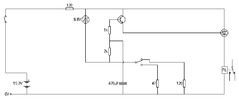

            • #96
              Basic Crowbar Circuit
              @ BroMikey
              Hi have put together a circuit you can try out, just need to post the image over... have not got a clue how to send it on this site?
              OK have worked out how to send a thumb nail image at least a start.
              • #97
                @ BroMikey
                This is my alternative crowbar circuit, the transistor is BC547 / BC182 and zener is 500mW details are open to experiment and a gate resistor can be included to suit device in use. two switch positioned shown for 15.2v and 12.7v
                [IMG]Thyristor trig.gif[/IMG]
                • #98
                  Originally posted by Dupe View Post
                  @ BroMikey
                  Thanks Dupe
                  My crowbar gate is half cracked open sometimes if a small
                  battery is sulfated and rejecting the charge. The spikes
                  can be trouble for gates I see.
                  In other words the LED gives off a pre-glow
                  very faintly lit. The spikes will eat my gate huh?
                  This version seems like an improved solution.
                  I think this is what you meant?
                  I will build it soon.
                  Okay I am back Dupe after some tests and it is confirmed
                  my LED on the relay is faintly glowing and it reads .5v there.
                  Of course for that LED to glow at only .5v during operation
                  shows that spikes are getting through.
                  I am doing your build now and will see the difference.
                  Thank you

                    You can possibly use a clamp suppression diode to add further protection to your circuit choose a voltage in excess of your maximum charging source voltage check their current handling capacity to match in with your designs.
                    My circuit should work ok for you ... I normally build on bread and use a variable PSU to finally check the trigger points etc.
                    Thank you
                    OK Mikey... should work fine, I always build my designs on bread board first before knocking up a circuit board this gives me a chance to trim values if necessary. If you have a variable PSU all the better.
                    • BroMikey's SSG
                      Just had a thought about your spikes!! you can get transient suppression diodes that will conduct above a given clamp voltage, might be worth looking into to add further protection. Hve a look here:-
                      • Originally posted by Dupe View Post
                        Hello DUPE
                        Yes I have it assembled on a bread board and O use those bread board
                        jumpers you can buy on ebay. It really makes circuit building fast and
                        easy.
                        On the TVS end of things. I have seen these and have some but never
                        thought much about using them on an SCR gate. Why not. I can always
                        push one down into place to give it a try.Good thinking.
                        And on part voltages I agree for a 12v operation the device should
                        at least be rated for 35v-50v max so as not to damage.
                        I also have number of precision variable voltage supplies plus the
                        constant current. Yes I test this way at first you are right.
                        I am now looking at your circuit design.
                        Then when I look around at other similar circuits it looks
                        to me like the small switching transistor is some sort of
                        regulator?
                        I am not sure. Or is it that the transistor opens first and then the SCR?
                        I will finish it tonight.thanks to you.
