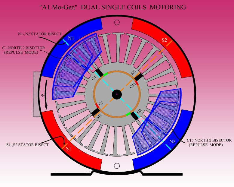

              We need the proper amount of resistance for my 4 magnet, 28 armature pole motor. The motor will be wound one of these 3 ways.
              1.) All inputs parallels connection...
              (Keep in mind that "all parallel connections"... Thin AWG wire is needed.)
              2.) The two N. magnets' channels/singular coils in series with two S. magnets' channels/singular coils in series. N & S in parallel.
              (AWG of medium thickness)
              3.) All four inputs in series.
              (series connections... Thick AWG)
              * 20awg - 16awg should be the range*
              Another factor which determines the AWG is... whether the motor is wound for repulsion or attraction mode.
              Here's where my "guideline rule" comes into play.
              "Guideline Rule", each Singular Coil was wrapped around 5 poles which was the same size as the magnets. The Guildline Rule "coils ABOUT the same size as a magnet" is for motors that are NOT using Extra Brushes! ... Example: The number of armature poles are divide that by the number of magnets. If that # is 5 or greater, my rule applies. 28 poles divided by 4 magnets/stators = 7
              *Attract mode, I would use the same size coil as the magnets or one pole MORE
              *Repulse mode, same size as the magnets or one pole MORE
              Attract mode options = better efficiency... about the same amount/weight of copper being uses.
              ( At the end of the day, I theorized that the same amount of wattage will be used.)
              or
              Repulse mode options = better torque and RPMs... about the same amount/weight of copper being uses.
              ( I theorized that the same amount of wattage will be used.)
              Opinions, thoughts?
              Keep it Clean and Green
              Midaz

                    • Hello my fellow nerds
                      I'm finally back to work on my EV motorcycle project again.
                      I've decide to wind the A1MoGen with 19.5awg. I thought about using a thicker AWG, 17awg in series but...
                      I chose to use a parallel connection @ ALL 4 GATES/inputs(*motor only), singular coils wrapped around 7 armature poles, 30turns per coil and the "timing" will be set almost equally between the North & South stator magnets using attract and repulse.
                      19.5awg is on back order and should be delivered in 10 business days
                      Keep it Clean & Green
                      Midaz
                      Ps. An acquaintance's electric motorcycle. I suggested the motor... #NeverLeftTheGame
                      [VIDEO]https://m.youtube.com/watch?v=NagmzAJbBn0[/VIDEO]
                      • Fellow Nerds... I say FELLOW Nerds proudly!
                        My "guideline rule" is to use singular coils about the same size as the magnet or one pole bigger than the magnet. ... It's is a good hint but not a bullseye everytime. Some variables come into play; room/space for coil winding, amount/# of poles and size of commutator brushes.
                        For example: "Battle of the windings" with the 5 pole motors. By design of the FACTORY commutator brushes, the singular coil(NS3)was at a disadvantage for rpms... Brushes alittle larger than a commutator segment would have given higher RPMS.
                        The biggest teacher for these Asymmetric motors/generators is the simplest design = The wonderfully simple 3 pole! Its a perfectly flawless example of Singular Coils in harmony with the stator magnets! The singular coil must use(*timing) the North & South stator magnets equally to create magnetic harmony.
                        From experience: If you deviate from the 3pole example, you lose!!!
                        Midaz
                        • This is an example of DEVIATING from the 3 pole example
                          This is my previous work/last build... It is wrong when it's a motor only using the P56's factory brushes
                          I didn't use the North & South stator magnets equally for magnetic harmony.

                            ***Divided by***
                            Stator Magnets ...4
                            Suggested # of poles = 7
                            28/4 = 7poles per singular coil (Simple right!? )
                            Hey! Why not 8 poles or more!?
                            Ok, if you use all 4 inputs/channels AND wind 8 or more Armature poles...
                            1.) The coils' magnetic north & south fields share the same magnetic space!
                            2.) Some armature poles have to project a North & South field(s)... At the same time!
                            *I don't know about you but that does NOT sound like MAGNETIC HARMONY to me.*
                            (If you want to use 2 inputs/channels only... 8 poles would work but I like 11 poles better. )
                            Midaz

                              When I started this thread, it was about singular coils around the same size as the stator magnet with adding extra brushes. Adding the extra brushes was/is very important because they would give you the option of mimicing the "3 pole motor's" magnetic interaction and/or drawing energy... It was my thoughts on how to modify the Imperial P56.
                              What I'm presenting now has nothing to do with "extra brushes". It's just a simple straight forward motor build ONLY. I'm following the 3 pole motor example's principles and how I understand them... It's not complicated at all.
                              There are a lot of members with the Imperial P56 motor frame(s) collecting dust. Everything that I'm doing is just a little common sense. Most of you guys have excellent motor building skills but it's not required. IT'S THAT SIMPLE!
                              Midaz

                                Using all of the info above has lead me to wind the Imperial P56...
                                19.5AWG for optimal ohm range, Independent singular coils of 7poles @ 30-34 turns
                                (*The magnetic domains of an armature poles NEVER share south and north orientation. All projected north and south magnetic fields never share the same "air space")
                                TIMING of the P56 energized coils is between the north stators bisector and the south magnet stators' bisectors is almost equal. This will allow you to achieve maximum RPMs and torque. (*Maximum amount of turns for the two coils energized by the brushes, starts a tiny bit after TDC on the repulsion field bisectors of the stator magnets)
                                Midaz
