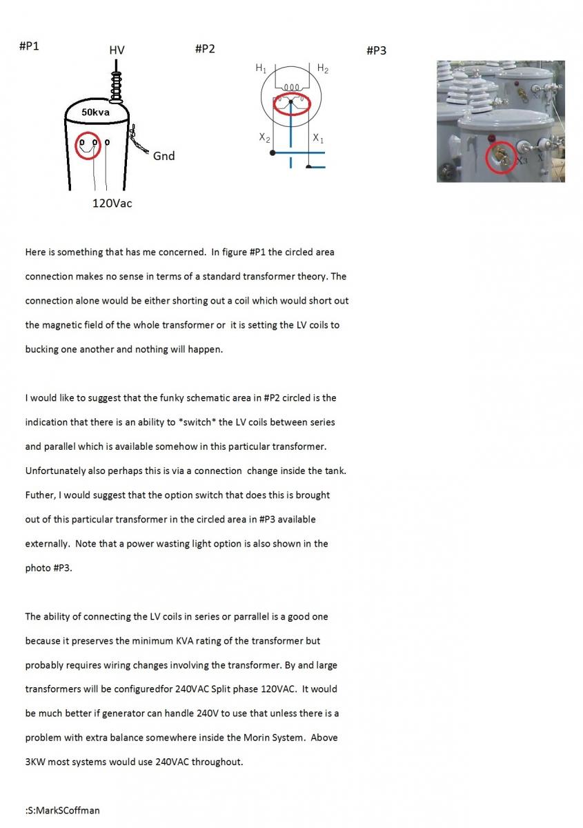

    These transformers like all other device have manufactures specification
    sheets showing all the options. I suspect no one of us wants to admit we are gringoes
    at power electronics enough to ask for them - they will vary between manufactures.
    Also the nameplates on the transformers are heavy duty - strictly useful information
    for determining if you've got a 25Kvar 14.4KVAC capacitor vs. a transformer.
