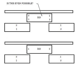

                          See the attached picture. I still see 8 poles (not stators) at the exact midpoint, but you see pretty much the same things I see going on, the magnetic circuit is in a very fluid state. The nearly short circuiting of the magnetic circuit at that midpoint instant may be the real cause for the doubled frequency. At this point who really knows?
                          In any case I have a feeling there will be a secondary low amplitude output caused by this. Sort of a superimposed AC ripple in between the large sine wave output.

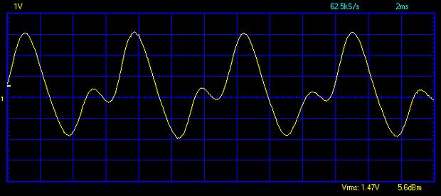

                            Scope shot of test unit output
                            High All
                            I quickly put together a small setup just to see some of what is claimed "not self run, I did not expect that with my setup", just to see the cogging and to scope the output, also to see what drag there is when shorting the output.
                            To start with there is heavy cogging, when shorting there is next to no drag and once turning with a little speed the cogging seems to reduce a lot, current draw drops to half.
                            I'm not a motor man but look at the output wave form, the frequency is 160hz and a duty swing of around 60/40 which maybe due to unbalanced coils!!
                            This is a converted computor fan, so was not expecting much output.
