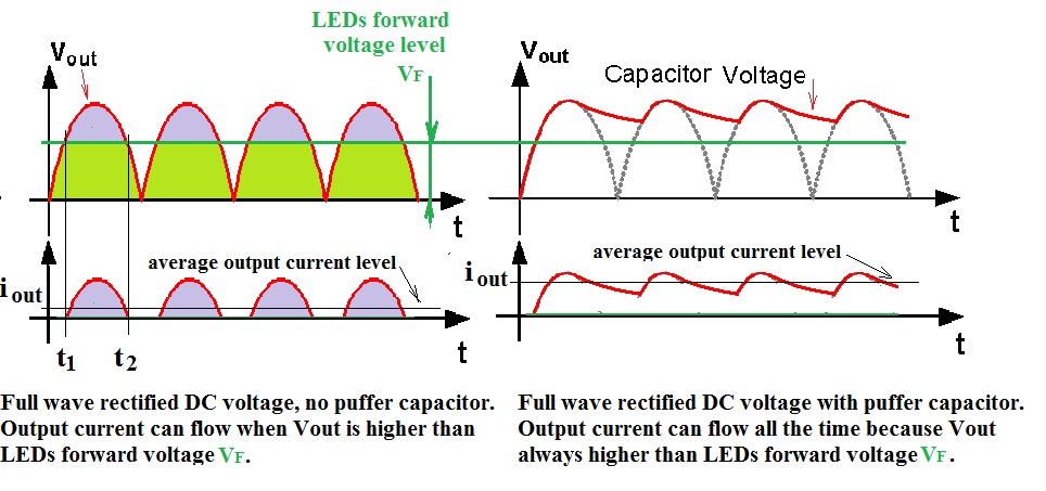

                      I have made a drawing in Paint to illustrate how a LED diode as a load may behave when we talk about current draw, depending on the output voltage level of a full wave rectifier bridge versus the forward voltage threshold level of a LED.
                      You can see the big difference between the average load currents when there is no puffer capacitor at the diode bridge DC output. The load current becomes "intermittent" whenever the instanteneus voltage level goes below the forward voltage level of the LED, while in case of using a puffer capacitor, the current is able to flow continuously, provided the coils AC output voltage is still maintained by the generating process for the increased average load current too (so the output power does not remain in the coil as heat loss due to the increased load current).
                      You did not mention in the video whether you had a puffer capacitor at the diode bridge output.
                      So your LED diodes as a load surely represent at least a several hundred Ohm equivalent resistor, perhaps near to the lower kOhm range, so if you still have the setup and the mood, try to use a 1 kOhm or higher resistor load and see whether the DC output voltage tends to increase by 1 V like with the LEDs. Perhaps a 2.2 or 4.7 kOhm potmeter would serve for this test as the load, setting it to the high kOhm range and coming down with it while watching the output voltage level. This way you could estimate fairly well what power a group of 'bright' LEDs may consume. (use a 220 Ohm or so resistor in series with the potmeter to protect the latter from burning the resistive layer under the wiper)
