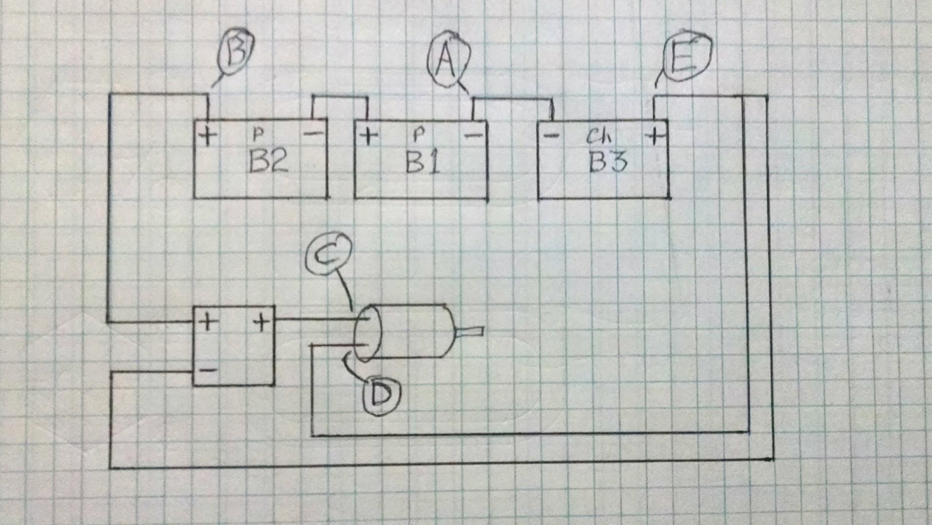

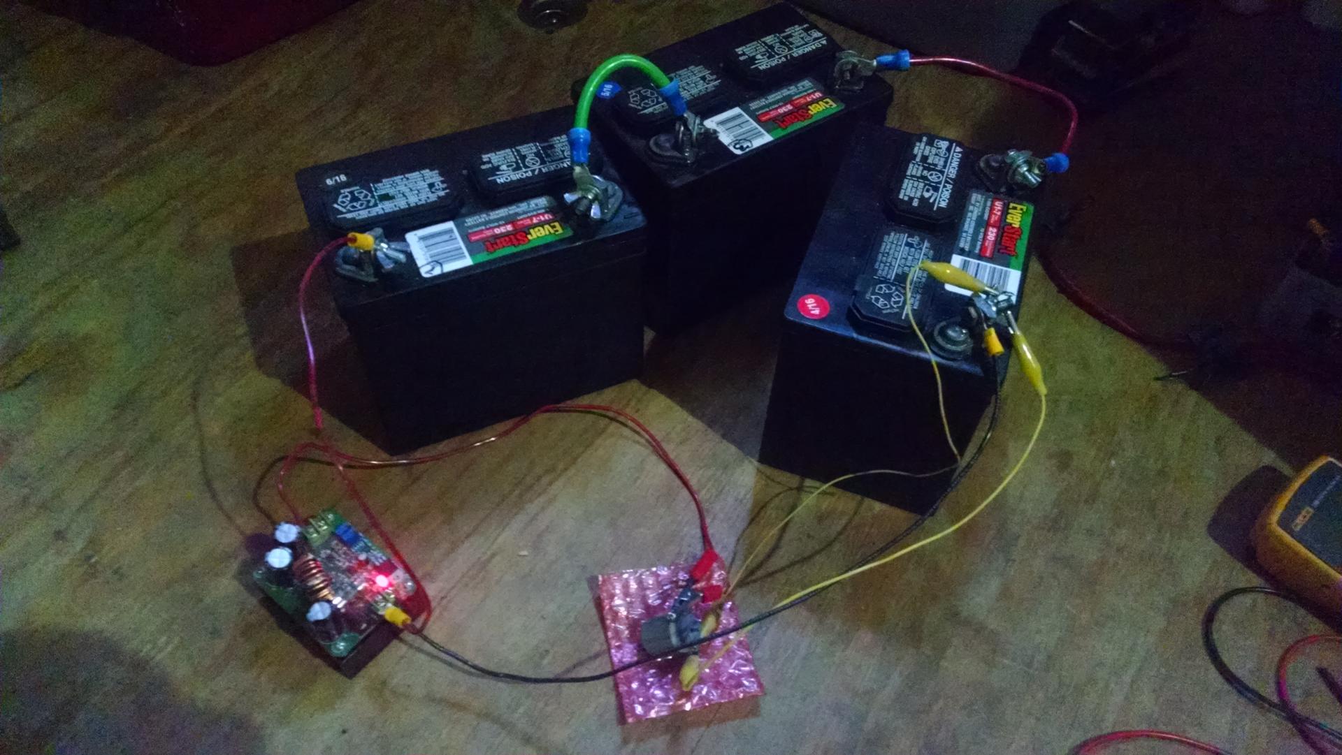

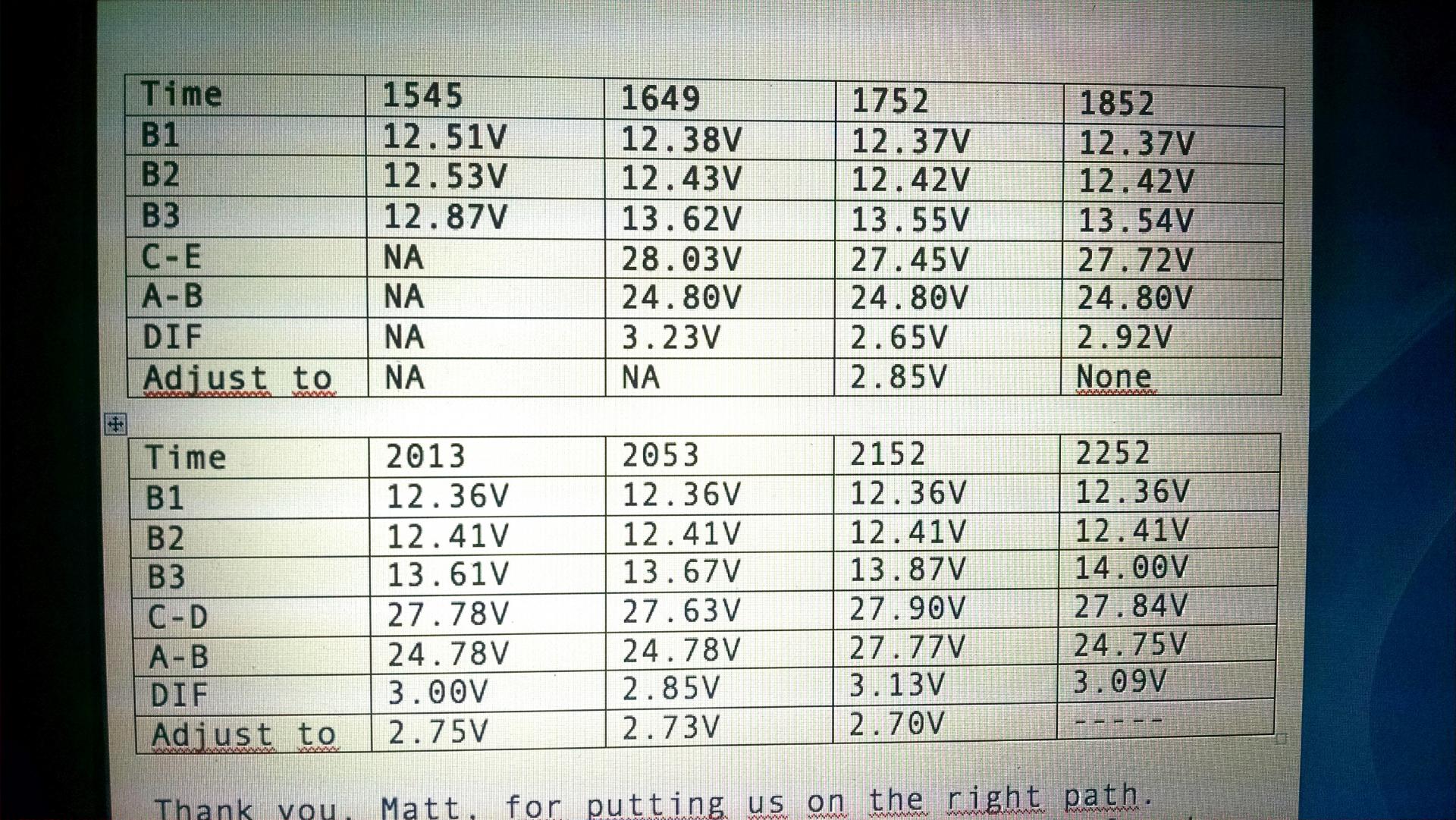

    My results were not so good last night.
    As soon as I connected dc bulbs (or motor) of any size across the booster and positive, the batt2 decreased quickly in voltage. Even with two in parallel. Quickly I stopped the test.
    So for next couple days will be going through all my battery bank to refresh and refill, then do a prolonged pulse charge with the Imhotep fan charger or my digital pulse charger. So this takes time per each battery. Should've bought the deep cell instead of hybrid deep cell/fast start batteries.
    Glad others are still at it.
    Off topic; Imhotep pulse charged a riding mower battery for (3) months while in Japan, the voltage/amps still good two years later and always connected winter and summer. Was dead battery before pulsing charge. Yes someone checked for me while gone.
    I thought batt2 was first in the two batteries in series which has the booster attached to batt2 positive?
    Wiring is connected correctly as per all the diagrams and such. Believe me I've tried everything to make this work.
    But my boost converter is same as you just linked about. Ive seen this happen with batteries before. Quick charge is quick discharge. Electrolytes and sulfating is the problem.
    Still here but busy pulse charging these batteries.
    Thanks Matt and I'll recheck my wiring to be sure.
